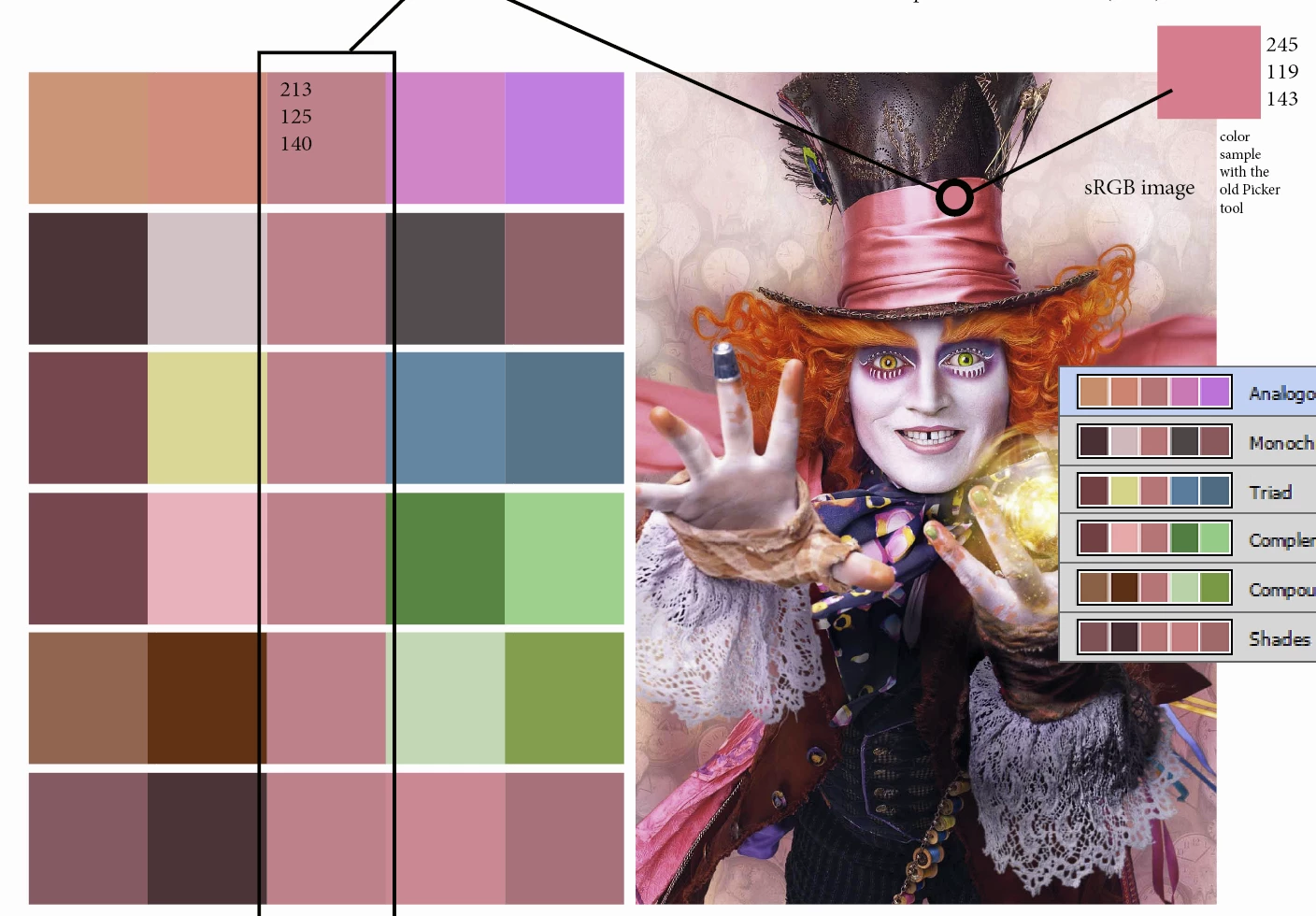

    Here's a fresh, new experiment this morning.
    The Document Intent is Web.
    I used the Shift key along with the Color Theme Tool to capture this single color in the mad hatter's hat.
    I get the 6 harmony rules.
    Generated swatches are in RGB space.
    For curiosity, I took a sample of the same area with the old Color Picker tool -- see swatch on the right, top.
    Why does the color has to be "dumbed-down" from what it is, in the image? Why? Why? Oh why?
    It's as though the color *has* to be converted to the Working CMYK space *first", before being converted to RGB.
