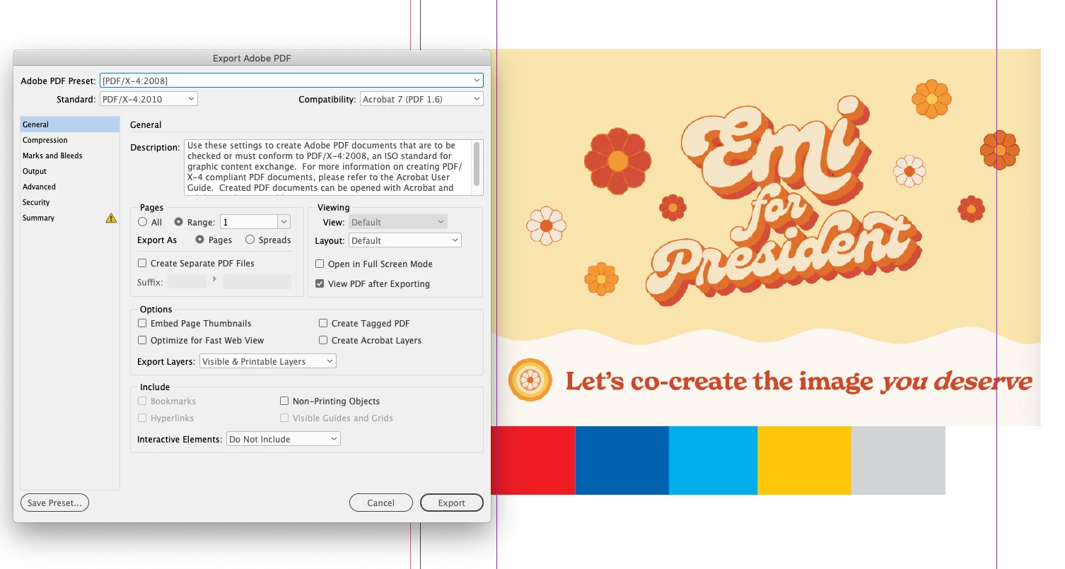

I have a CMYK document that I'm trying to export for printing (I'm a newbie when it comes to printing). When I export it as a PDF Print the colors are faded. I looked through all the other questions on this board with similar problems, but none of the suggestions have worked. Also, I checked the exported PDF in both Apple Preview and Adobe Acrobat, and the colors look muted in both. Any help would be much appreciated!

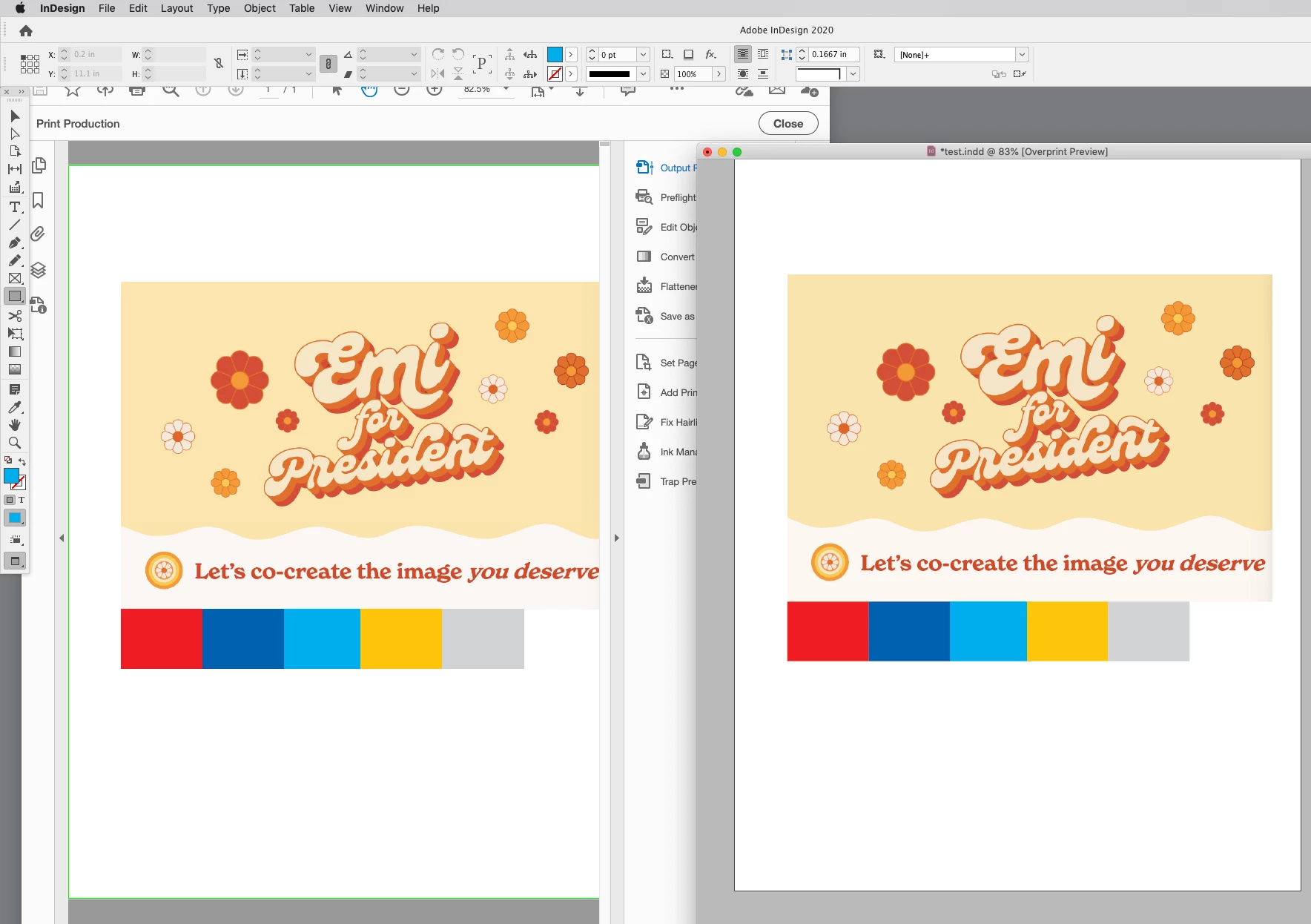

You should be able to export the color (CMYK or RGB) you are showing in your captures unchanged to Acrobat.
All of the color in your example is in gamut and printable. Try exporting to one of the default PDF/X presets and view in AcrobatPro with Output Preview turned on. The PDF/X standards all include an Output Intent profile which is used for the soft proof in AcrobatPro, and should match the InDesign preview when Overprint Preview is turned on. Here’s PDF/X-4:

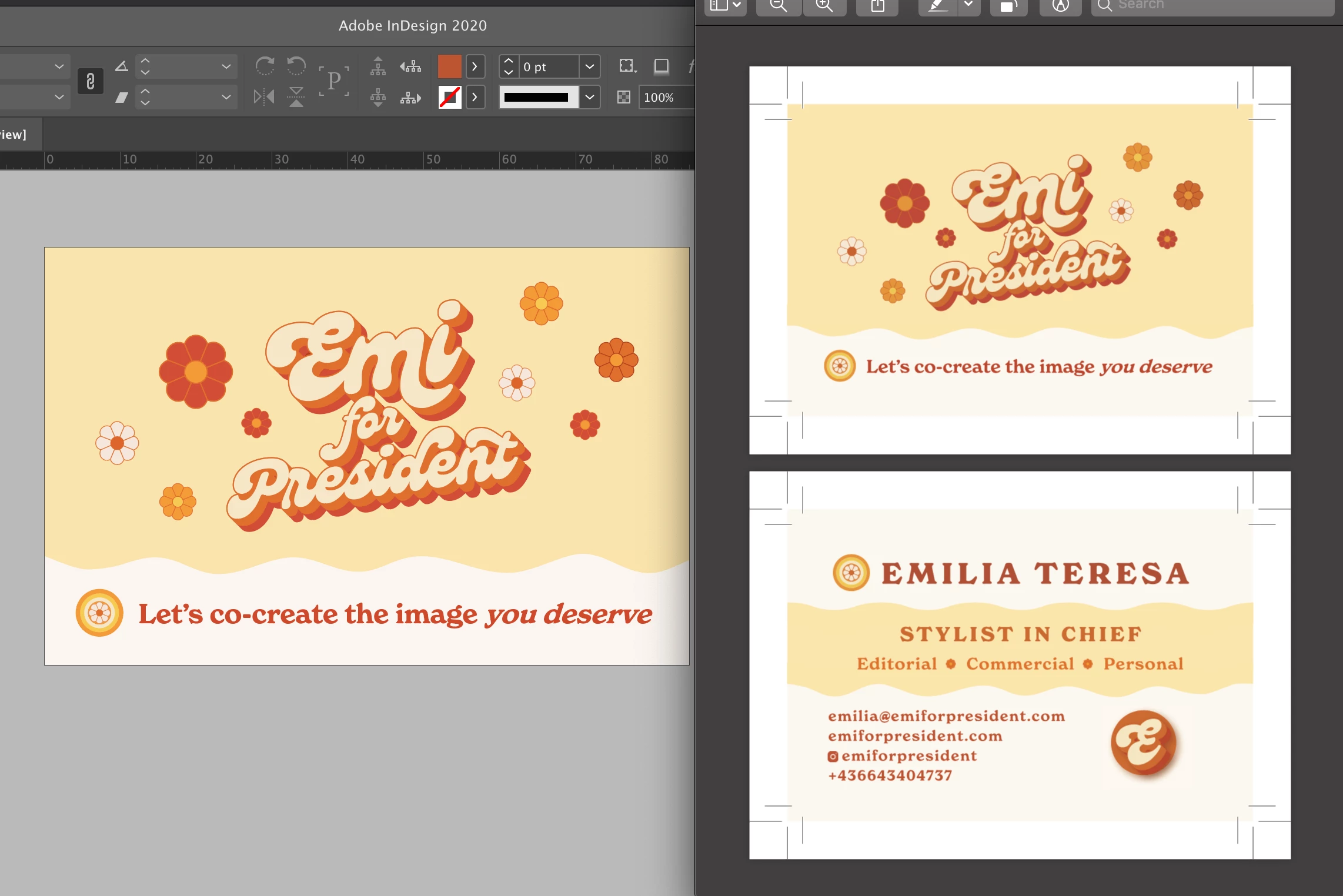

Firstly what is your intent? This looks like a business card, are you intending to print?
I agree with previous posts. The limitation is in how physics work. In CMYK orange is produced by overlapping Yellow (blocking blue wavelengths of light) and Magenta (blocking green wavelengths of light), due to the nature of these colurs bright orange is not possible to accieve in this process. This is the reason companies that have bright orange in their pallete will print using Spot Colour (usually Pantone Colour matching system).
There are inkjet and fixed palette printing systems that include an Orange colour to expand the range of colours made available, but iýou would then define the colour as a spot colour to be matched as good as possible at the printer. (The most cost effective way to create your design may be to find a Riso printshop that have oranga and yellow, or warm red and orange, In Indesign it is possible to mix two spot colours in by creating mixed ink swatches https://design.tutsplus.com/tutorials/quick-tip-how-to-create-mixed-ink-swatches-with-indesign--vector-3859 … but this is not a beginner feature)

what export settings did you use? Try exporting to PDF/X4 (selecting PDF/X4 under Standards).
