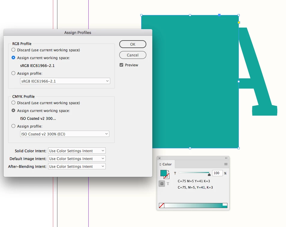

Here my InDesign doc has ISO Coated v2 300% and sRGB assignments—the A is placed from Illustrator, and the rectangle is filled with 75|5|41|3 CMYK, which you can see in the Color panel

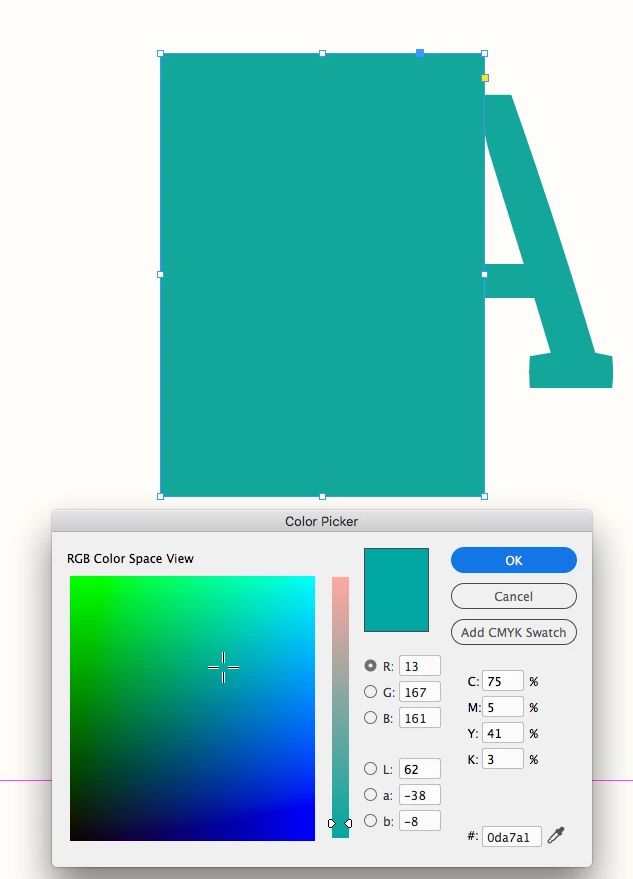

The InDesign Color Picker will show me the conversion of the CMYK color into sRGB hex and I get #0da7a1

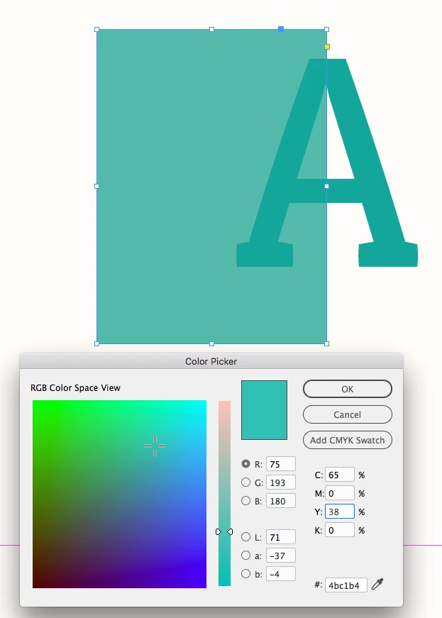

If I select the RGB Space View and enter your #4bc1b4 hex value, the Color Picker gives me its closest ISO Coated v2 CMYK value, which is 65|0|38|0
