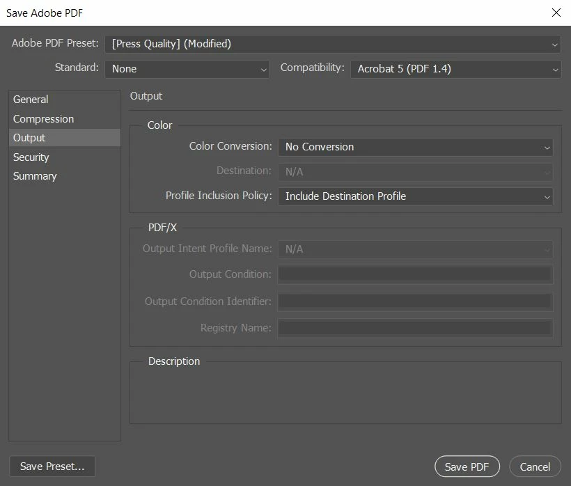

I have a few images that are in RGB that I need to save as PDFs before printing, but the colours are seemingly changing and becoming "dull" when I save as PDF. This doesn't happen with JPG, PNG, or SVG. I have tried to stop the problem by saving setting the colour conversion to "No conversion" but that hasn't seemed to change anything.
Additonally I heard that it could be an issue to do with the PDF reader I am using so I installed Adobe Acrobat Reader but that is showing the colours in the same washed-out way.

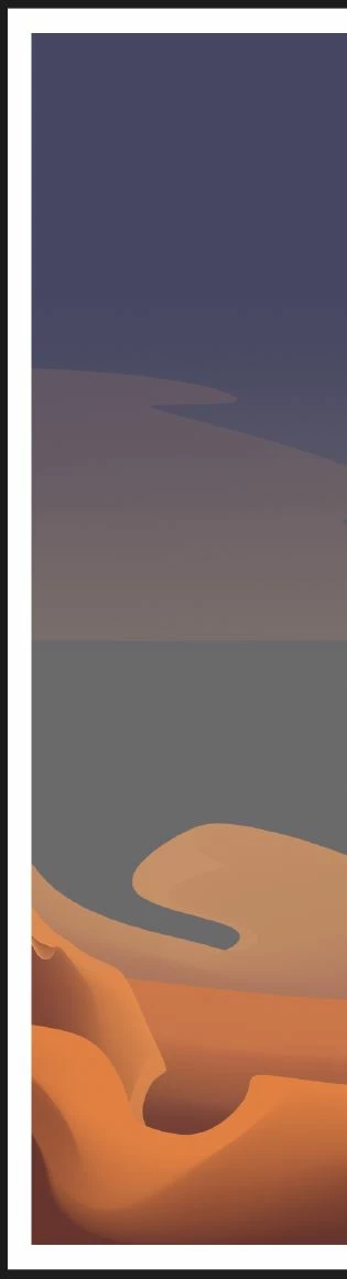

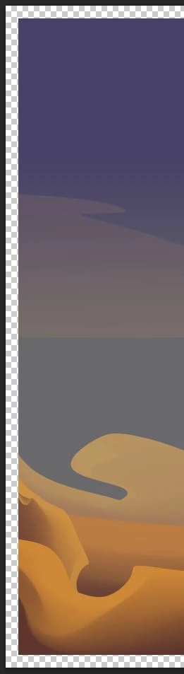

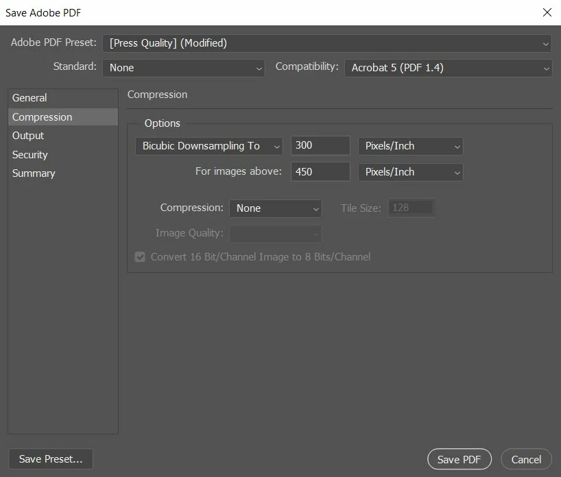

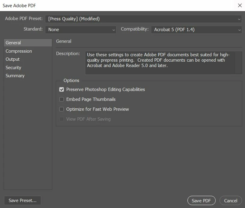

I have attached screenshots of the save as PDF settings that I have used, as well as screenshots of the colours as they appear in photoshop vs. PDF.

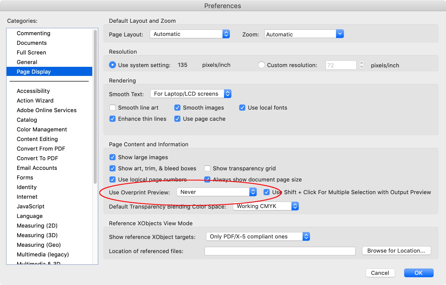

Hi @Simon37488132gmvl , Also check your Acrobat Page Display Preferences are not set to Use Overprint Preview. If that doesn’t work can you attach the Photoshop PDF?

Hi Rob,
That hasn't fixed the issue but when I open the PDF in photoshop the colours are correct so I can tell it's an issue with the PDF reader not the file itself which is all I needed to verify. Thank you for the help though!
