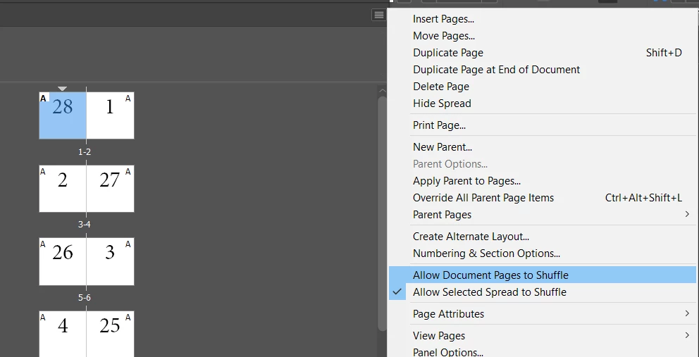

comment déplacer ma dernière page à gauche de la première page dans indesign
Ma page 1 est seule à droite, puis dans une planche double 2 à gauche et 3 à droite, puis 4 a gauche et 5 à droite. Comment ramener 28 à gauche de 1, puis inverser 2 et 3 pour préparer une impression recto verso chez moi et non à l imprimerie.

Thank you very much. I finally made it by exporting each page one by one and reorganizing the order of my pages as I wished. Previously, I could put them in the wanted order but the program changed the numbering of tha pages, and that fooled me. So thank you anyway!

Are you doing something like this?
Created a 28 page document
Then for printing started moving pages in the page panel?
So you've ended up with this?
And want the Page 28 beside page 1?
Make sure in the Pages panel that the option is turned off
Then drag page 28 up beside page 1

Mar 16, 2025 2:55 PM UTC
That can certainly work, although I've had good luck with the Print Booklet feature.  This method is a problem if the page count changes.
Mar 16, 2025 2:59 PM UTC
Absolutely, I'm just wondering have all the pages been rearranged already and they can't get the last page to sit next to page 1.
Seems like that's what the original query was.
I just offered it as a potential solution as it wasn't mentioned already.
