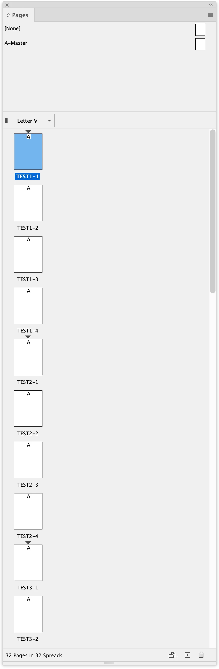

Gives me this:

Gives me this:

Hi @Magnetik85 , It seems to be working for me—if I check the first page’s label after running your script I get "TEST1-1"
$.writeln(app.activeDocument.pages[0].label)
//returns TEST1-1

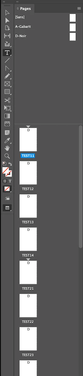

Magnetik85
February 3, 2023
Hi @rob day
It's weird since it doesn't work for me.
I recreated a blank document with 16 pages and ran the script above and I have the same problem. (see screenshot)

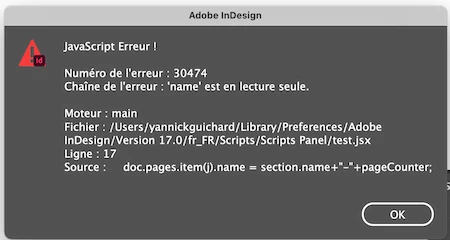

I tested the code that you also proposed to me but it does not work and I have the following error message:
