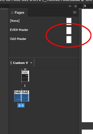

    MORE INFO:  I'm using FACING PAGES, so when I create 2 new pages they are automatically linked to each other.  They just don't link to new spreads as I create them.
    rob day
    February 3, 2018

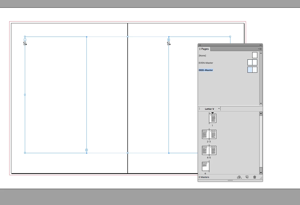

    Your document is set up as facing  pages but your masters are not 2-page spreads, so I think that's creating your problem. Here I can see your masters are single pages:
    When you use Primary Frames with Smart Text Reflow you don't have to manually link but the masters need to be spreads with the primary frames threaded.

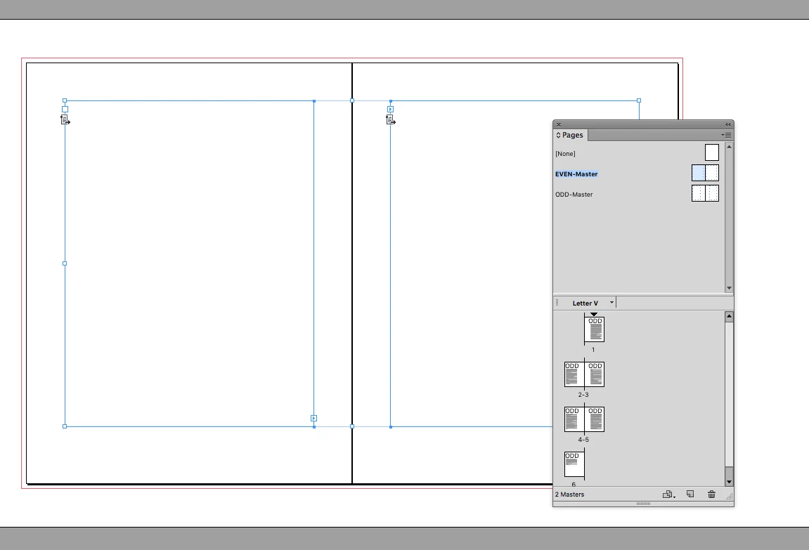

    To get the reflow to work set up your EVEN-Master as a spread and confirm that the text Frames are Primary—when a primary frame is selected it has an icon with an arrow:

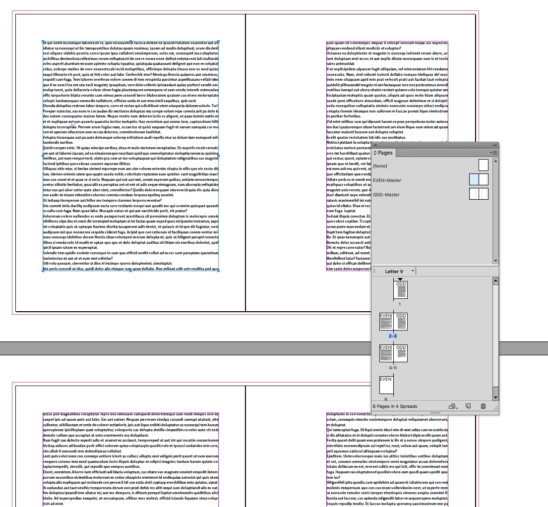

    Then duplicate the EVEN spread, rename its prefix, and make any desired edits. Here I've changed the margins and text frame dimensions
    Now If I add text to the end of the flow the pages will automatically be added if that's the preference. And from there I can drag and drop masters and the primary frames will update:

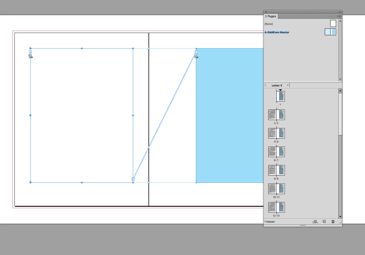

    Also, do you really need two masters? Couldn't it be one master spread with the left page the even layout and the right page as the odd layout?

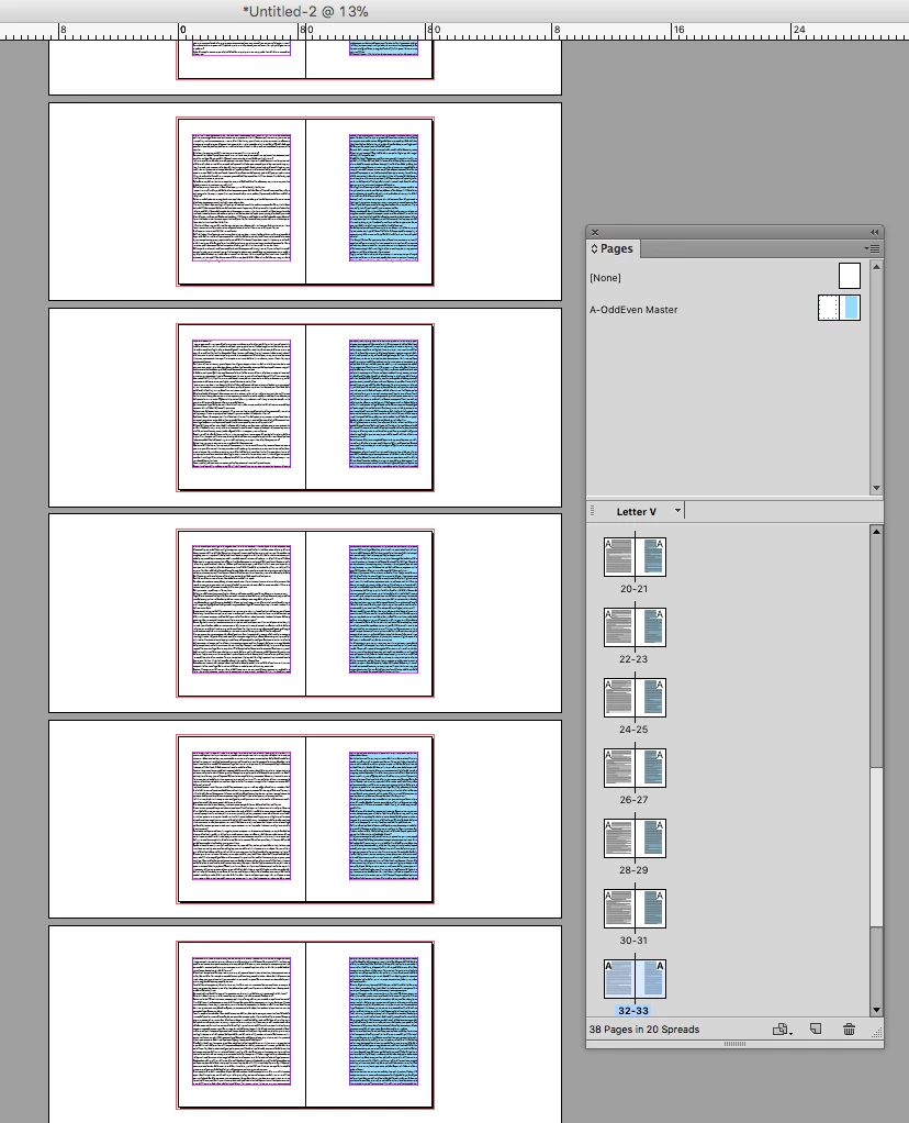

    OK!  It performs well that way.  I guess my initial premise was wrong.  I wanted to create a doc with 20 empty pages which would all have their primary text frames linked.  That's not possible, right?  Indesign will only add one linked page at a time?
    Derek Cross
    February 3, 2018
    Placing text using the primary text frame and pressing Shift will create the linked pages you need.
