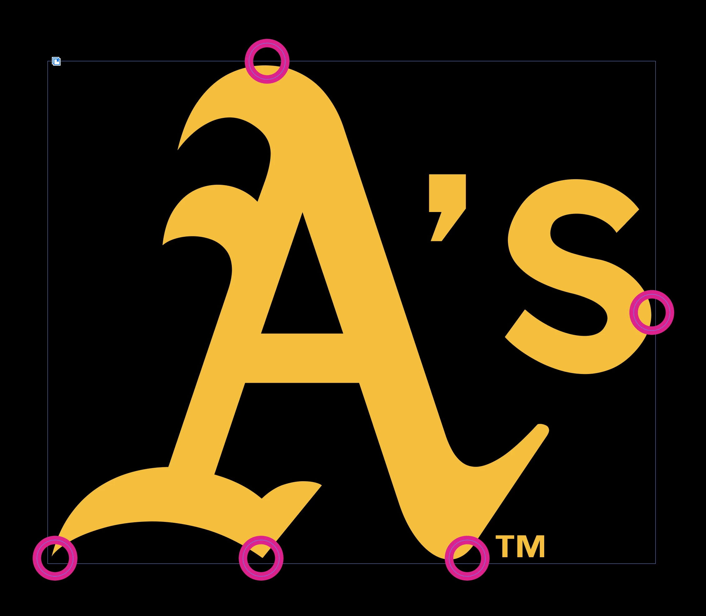

I have an .svg file that is exactly 1". When I do file > place (frame fitting options set to 0") it leaves .0278 gap all around the image. How do I remove the gap so the content frame fits exactly?

To start with, SVG can be a real pain the ASCII. You might experiment with the import settings to see if one or the other does a better job.
You might also consider converting it to a more standard and manageable format, like AI or PDF. Illustrator should be able to handle that.
If you have checked the frame fitting and other Ctrl-B settings and are fairly sure none are causing a border or spacing, I'd bet this is a border or margin or the like in the SVG itself; you may have to work around by zooming the image slightly or applying an inner stroke of the fill color to hide it.

if you have this vector artwork available in Adobe Illustrator make sure when you save to SVG that one option is NOT checked: [ ] Responsive. That should create no gaps at all. Note that option "Responsive" is turned on by default with Illustrator.
