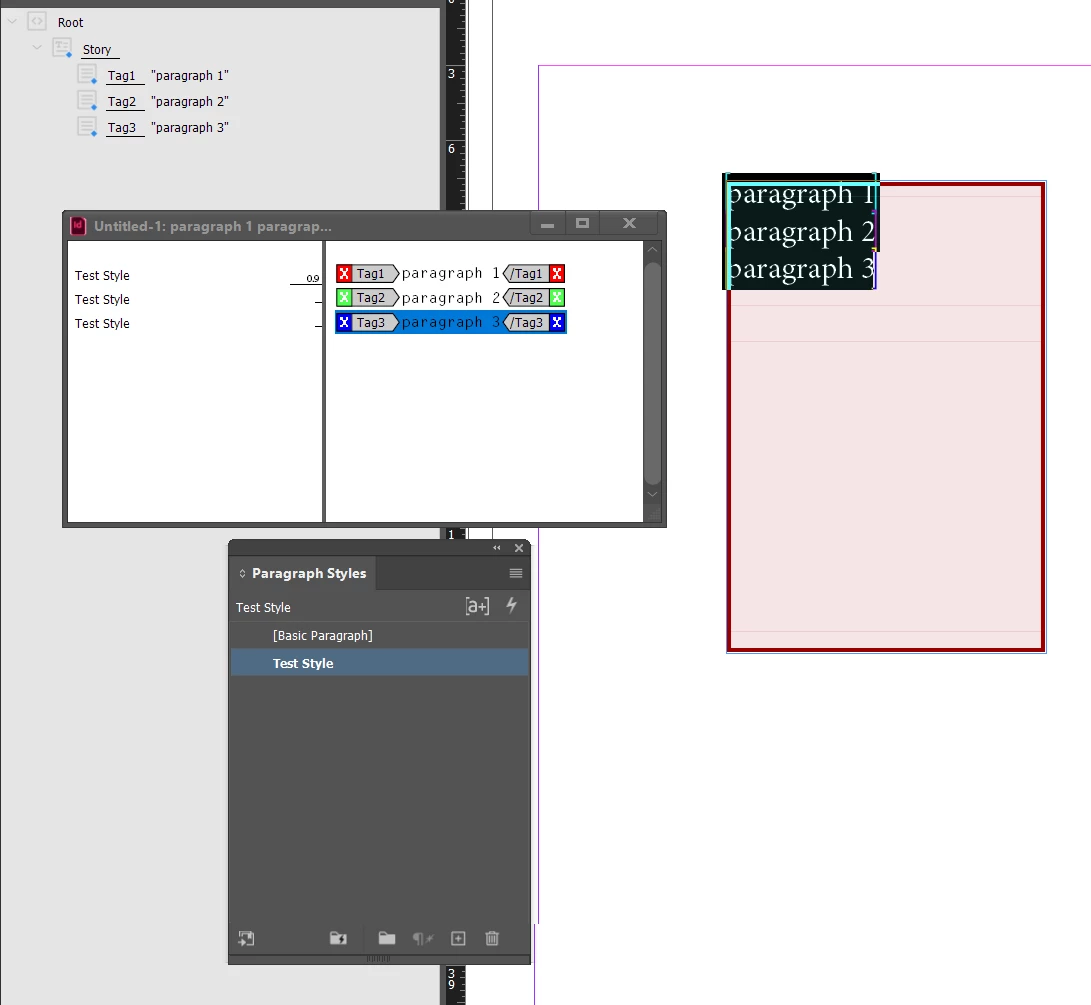

I have created 3 xmlElements inside the story. All three have same paragraph style.
// Just a dummy script for demo.
if (app.selection.length > 0) {
    // Get the selected item
    var selectedItem = app.selection[0];
    var test = 0;
In debugger,
selectedItem.textStyleRanges.length
1
selectedItem.textStyleRanges[0].contents
paragraph 1
paragraph 2
paragraph 3
What I want is since I selected 1st tag(1st xmlElement with content paragraph 1) only that should have displayed on debug console.
I need all the different style ranges  and contents from perticular xmlElement and not the contents from neighbouring xmlElements I know textStyleRanges returns that. But  is there a way to do what I want?

It looks like your three paragraphs are the same stylerange. I am not familiar with the XML structure, but, maybe you should be looking at that.

What I want is from the Perticular xmlElement say tag1 (has content paragraph1), Is there a way for me to get all textStyleRanges for that alone? Right now with current approach If paragraph styles are same
Mar 7, 2025 6:19 AM UTC
cont... from tag1 only im getting all three paragraphs, Its causing issue for the main task that we are doing.
