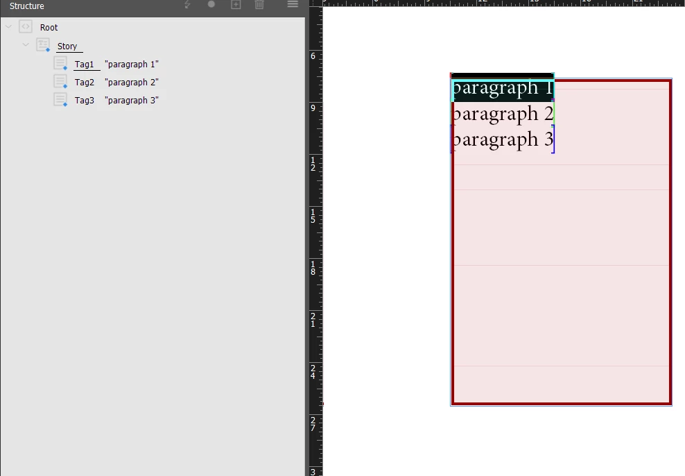

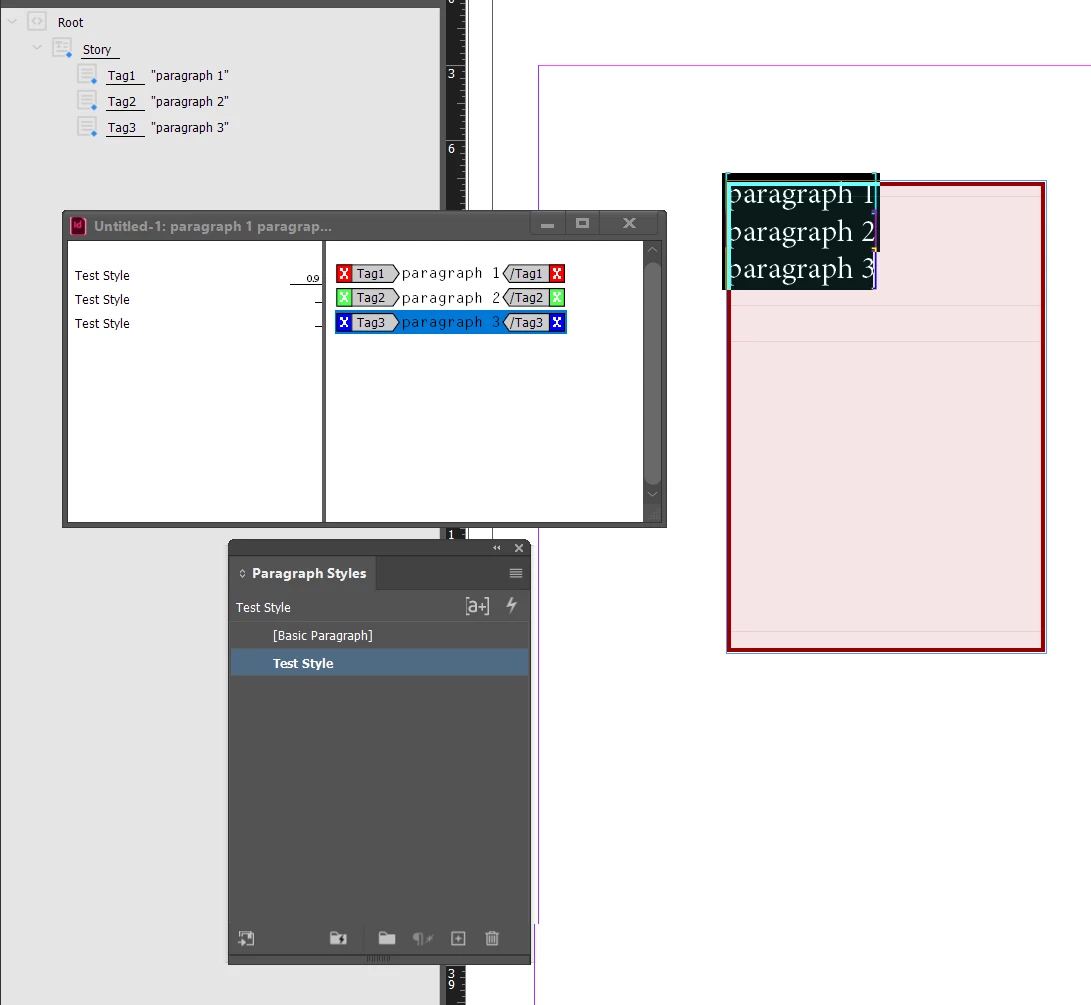

I have created 3 xmlElements inside the story. All three have same paragraph style.

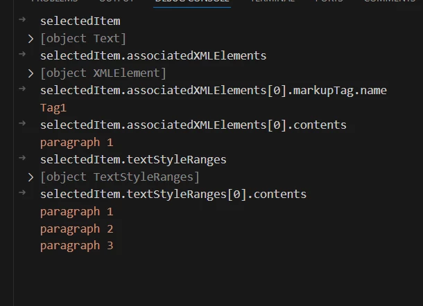

In debugger,
selectedItem.textStyleRanges.length
1
selectedItem.textStyleRanges[0].contents
paragraph 1
paragraph 2
paragraph 3
What I want is since I selected 1st tag(1st xmlElement with content paragraph 1) only that should have displayed on debug console.
I need all the different style ranges  and contents from perticular xmlElement and not the contents from neighbouring xmlElements I know textStyleRanges returns that. But  is there a way to do what I want?

But in your screenshot - you've selected all 3x Paragraphs?
Mar 7, 2025 4:58 AM UTC
Yeah, but even when I select the single xmlElement (paragraph), the same result im gettting.
Robert at ID-Tasker
Mar 7, 2025 10:21 AM UTC
Because TextStyleRange isn't split by XMLElements.
