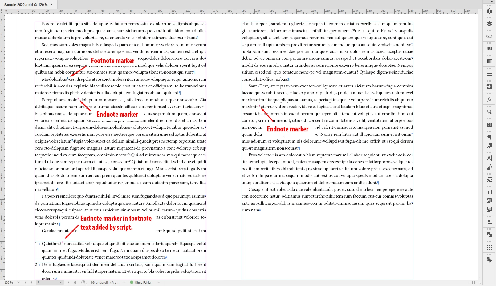

1106design said: "Peter, we're getting deeper into this enormous book and have discovered that the author has endnotes within his footnotes! Is this even possible in InDesign or should we ask him to revise?"
Hi 1106design,
endnotes within footnotes?
Not possible if you are using the GUI.

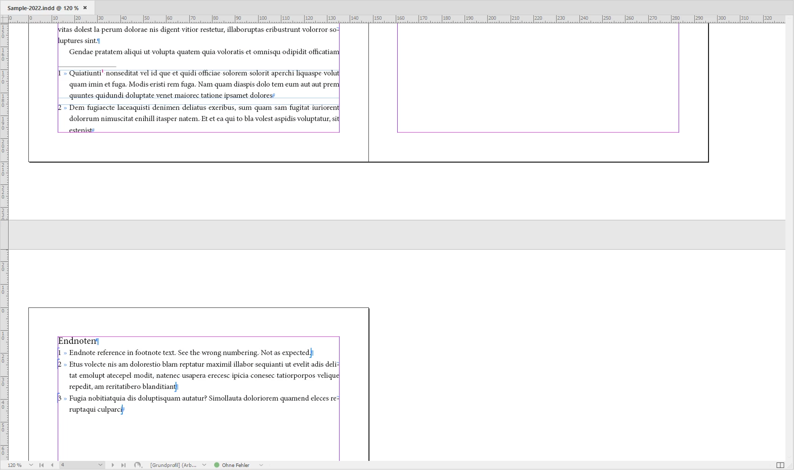

With scripting this will work. Technically it is possible to add an endnote to a footnote text. This is experimental!
And there is an issue. The numbering could go wrong. Below the code where I selected an insertion point in the footnote text to add a new endnote with:
app.selection[0].createEndnote();
See into my sample document:
Download my sample InDesign 2022 document from my dropbox:
https://www.dropbox.com/s/d9sh2287omknyb5/Sample-EndnoteAddedToFootnoteText-2022.indd?dl=1
