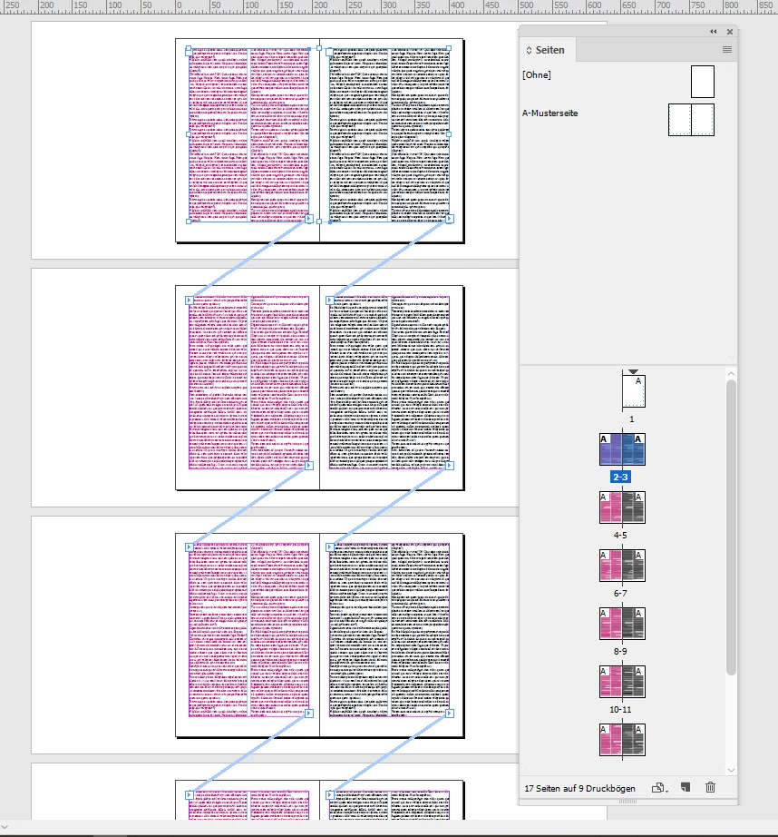

Hi Velleius,
Bob is absolutely right.
Below a sample with two text flows from my German InDesign 2019.
( With InDesign 2020 it's all the same. )

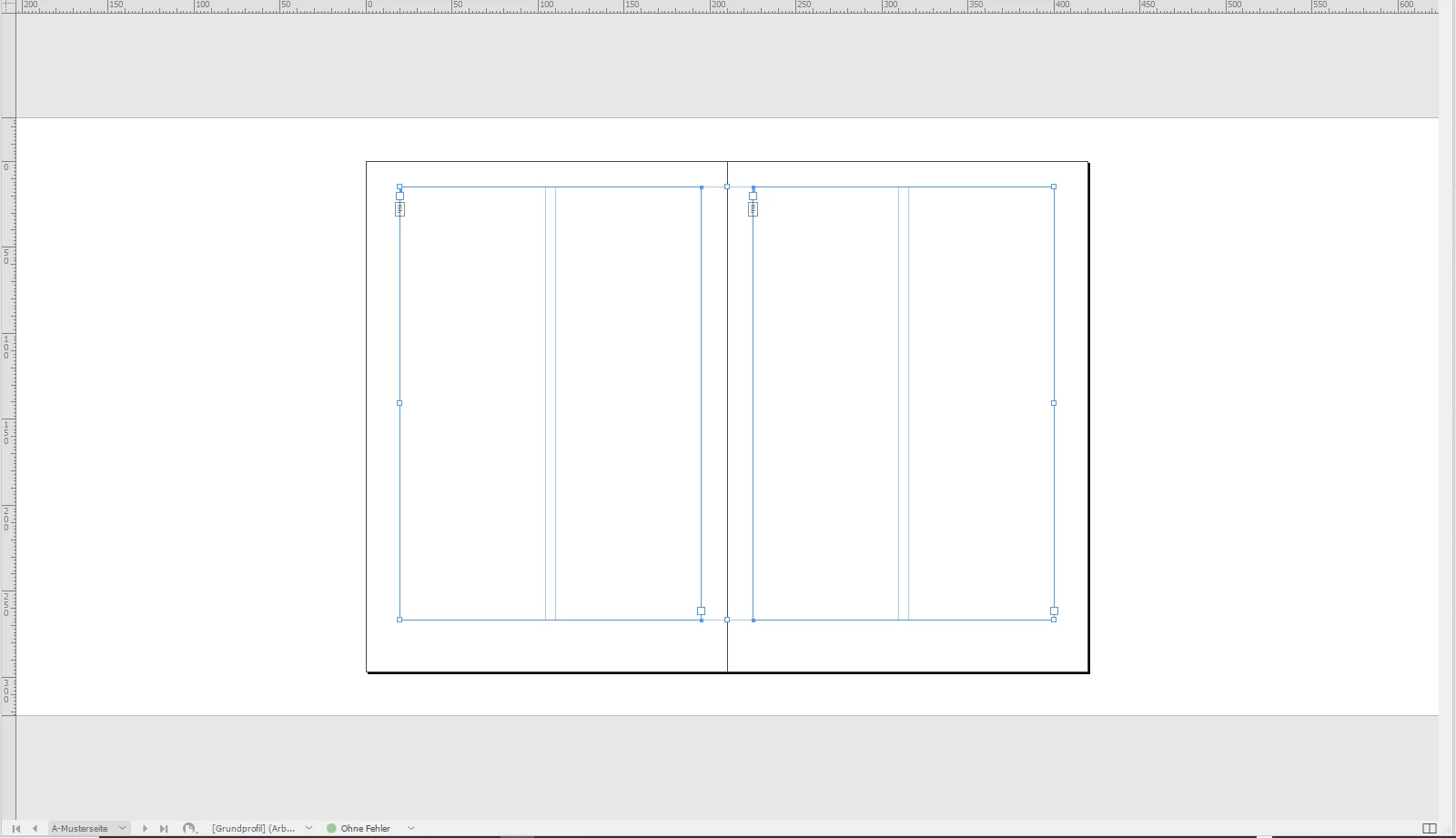

Set up master A with two text frames that are NOT primary text frames and are NOT threaded. Each on every page. In my sample I did text frames with two columns. The text frames' edges align with the page margins.
I loaded the original text ( formatted in black ) to the placegun. Went to page 3 of the document, held the shift key and clicked to the page inside of the margins.
Automatically InDesign added pages as much as necessary and threaded the original story's text frames on right pages only.
Did the same with the translated text ( formatted in read ) on page 2 of the document for all left pages.
The result: two stories side by side. Text frames on pages 2 and 3 selected to show the two threads:
All that should work by default if your document is setup with NO primary text frames enabled.
Make sure that both text frames on the masters align with the margins of the pages.
