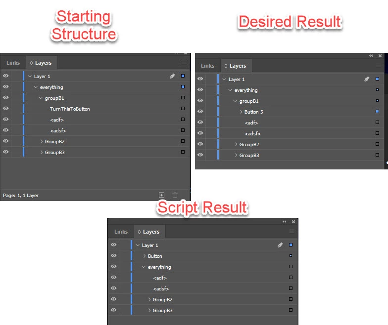

Been trying (coming on 20 hours now) to code a convertToButton function in UXP.
I thought I was don,e but then realized if the object I want to convert is double nested inside a group... and and/or inline in a text frame... it gets real messy real fast.
Hoping someone has already solved this in UXP.   If not hopefully what i have will help someone else... i wouldn't have gotten as far as i did without the below post.
i've referred to this page:
https://community.adobe.com/t5/indesign-discussions/how-to-convert-textframe-to-button/td-p/2668958
@sreekarthikeyank and @Marc Autret both have replies that were helpful but I'm still struggling with this function.   The functionality of convertToButton is exactly what i need as it doesn't pull the button out of the group its in.  (which i tried to get clever and put it back but when its nested a bunch of different ways I get hosed.
Here is my UXP script so far. You'll find a few workarounds in there... some likely not needed due to ignorance on my part.

  // WARNING currently this doesn't work if the itemYouLIkeToConvert is nested more than once.
  // I worked forever to get it working at one level but i need multiple levels
  // AND ability for the object to be inline in a text field

I may have figured something out.....
app.scriptMenuActions
however whatever that is only contains 2 items ....
they are
"Convert URLs to Hyperlinks..."
"Convert Footnotes and Endnotes..."
I'll continue digging around... it could be a clue
