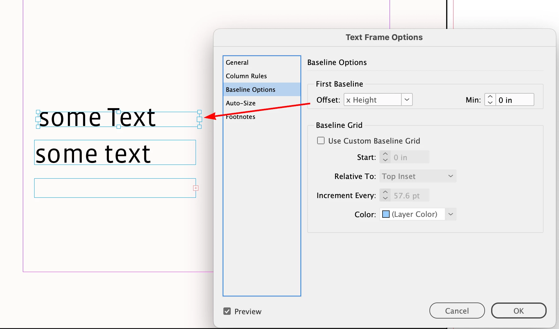

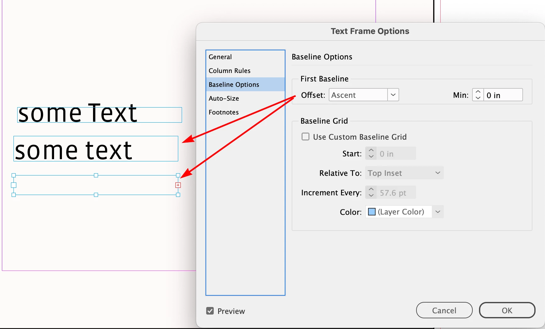

Hi ​@MarketingSchmidt , Check the pasted text frame’s Text Frame Options First Baseline Offset—the offset you choose would have an affect on whether the text will fit or not. The default text frame’s Baseline Offset could be defined differently in the source and destination docs

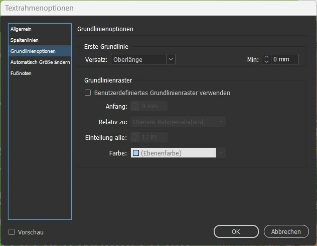

Hey ​@rob day thank you for the tip - i actually wasn’t familiar with the submenu ‘Baseline Options’ before.
The first option (“Oberlänge” in german, don’t wanna mistranslate and cause confusion) is selected as default and should, to my knowledge, cause the uppermost possible part of a letter to stick to the text field border. But still there is a margin of about 1,5 mm. I didn’t select any margin myself anywhere.
The other options don’t produce the ‘default-effect’ as well.
Do you have any experience about malfunctions in that area?
