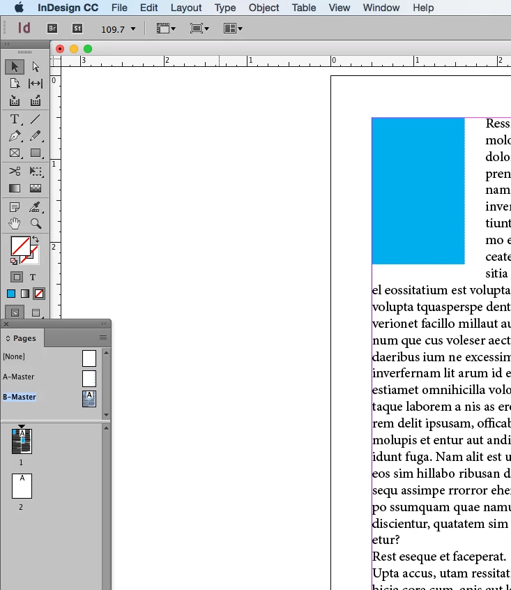

    What you actually needed to do is to create what is called a Master Page that can then be applied to as many document pages as will have the same basic layout. Depending on your layout it can be set up to either provide a page to page framework for which text can be flowed throughout a document or as a starting point for each individual page that can then be altered to fit then needs of that page. If you're asking if it will align all of the graphics in an existing document then unfortunately that is not the case. However, if the graphic elements are static on the page and it is just a matter of flowing in text around the graphics then that is possible with a Master Page. It is also possible to "anchor" graphics within the text and flow that in with the text. You can create a Master Page using an already layer-out Document Page.
    Notice that the newly created Master Page (see above) resides in the area above the Document Pages. Dragging this icon on top of any pages in the Document applies this Master to that Page.
    Masters can also be applied with the pull-down menu shown above.
    This is the basic concept and application of a Master Page. Before actually working with them it would be a really good idea to seek out a more thorough tutorial about their use on Lynda.com or possibly You Tube.

    To get a "master" layout propagated to other pages, you'd have to set it up on a Master Page, then apply that Master to other pages before you populate them.
    Learn how to use master pages in InDesign
