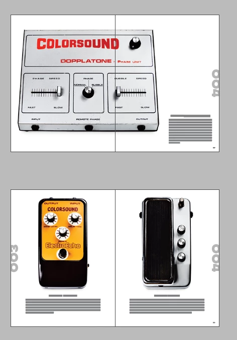

I have a book where I need to apply ascending serial numbers to pages.
I am using 4 different master pages.
Is there a way to create a numbered list that continues throughout different masters?

July 29, 2020
Thanks Mike,
The serialized number should not inherit the actual ID page number.
It's more of a list that ascends throughout the book.
In some pages for example, that serial number is not showing (using a master without that serail number).
