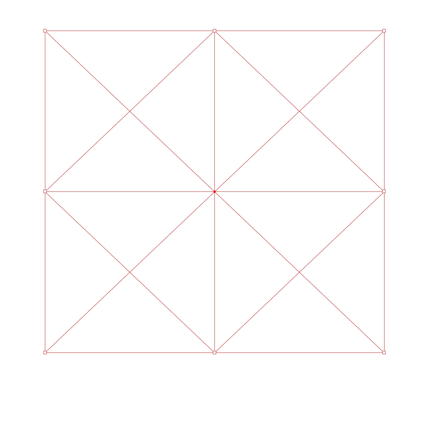

How do you create the gaps within the rectangle frame tool? I drag out and hit the up/right arrows to create the grid but there are no gutters/gaps.

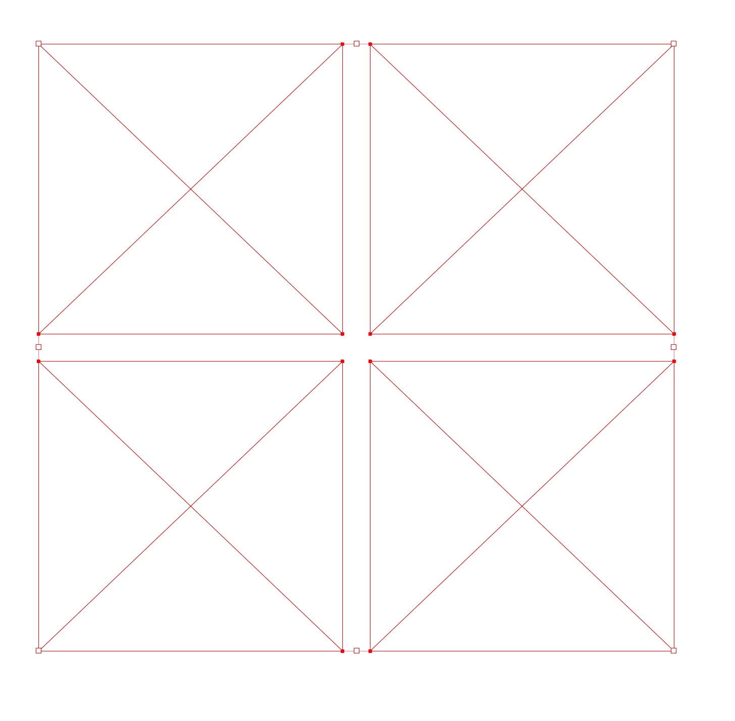

The gap is the Same as the gap between columns for the Settings of that page. You can change ist with arrows+alt/option and/or cmd/ctrl key and/or shift.

here is what I do:
  • while drawing a frame
  • keep mouse button pressed
  • press arrow up/down to create more or less rows of frames
  • press arrow left/right to create more/less columns of frames
  • press Ctrl+Arrow up/down to increase/decrease the heigth of the horizontal gap between frames
  • press Ctrl+arrow left/right to increase/decrease the width of the vertical gap between frames
  • then let the mouse buttin go
or
  • Create the first frame (keep it selected) and Edit>Step and Repeat

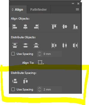

If they are already created, teh advanced options in the Align panel allow you to set a measurement of the gap between the shapes

Using the rectaangle tool, I click and drag to create the frame. While holding the mouse down, I use the up and right arrows to divide the frame into several frames. Like a grid. The works fine except I could not find how to get gutters/gaps in between them. Now I know that the gutters/gaps are set within that pages margins options.

Thank you very much! That worked!!
