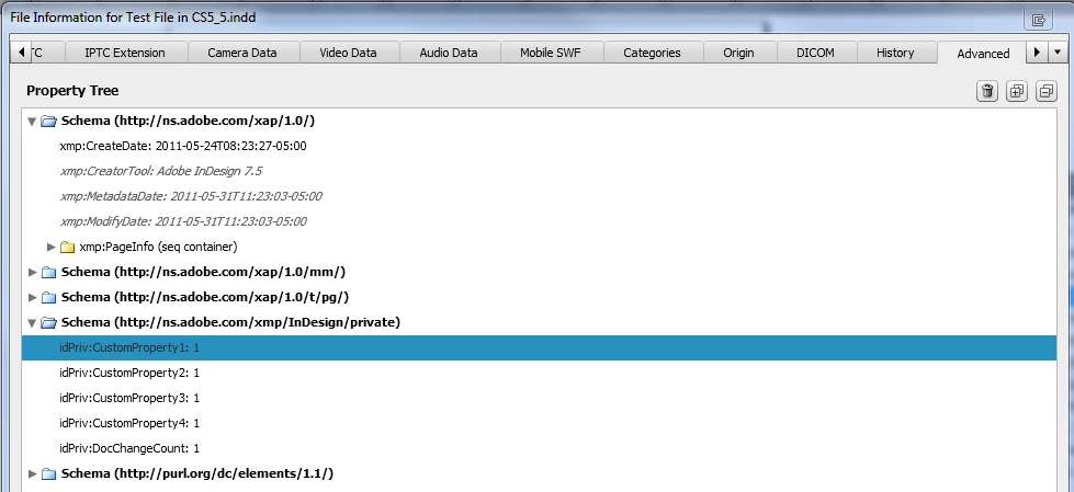

I'm trying to store some information about an InDesign file within the file itself using the XMP blob (MetadataPreferences). I'm able to set/get the values, but I'd like to prevent the user from being able to edit these values (they are controlling a workflow, and ideally we don't want the users messing with them). Currently, I can see the custom values view the File Info > Advanced tab, in the schema I put them. The user can't edit the values, but they can remove them if they thought too. This is what I want to prevent: I see some of the system values are in italics, which means they are locked down. Is there a way to, view script, specify a MetadataPreference object as read-only? I'm currently setting the property along the following lines:

In an XMP Schema, elements can be marked as internal or external. Applications which handle XMP metadata use the schema to display internal elements as read-only and external ones as read-write.
If there's no schema for a specific element, it's assumed to be external. Unless you can write a schema in such a way that inDesign can read it (and I don't know if that's possible), it's going to assume your XMP data is read/write...

This is not acheivable. If you need strict proof that the values have not been tampered with, you'll have to use cryptography (digitally sign your metadata and have your downstream application reject files lacking signed metadata).
