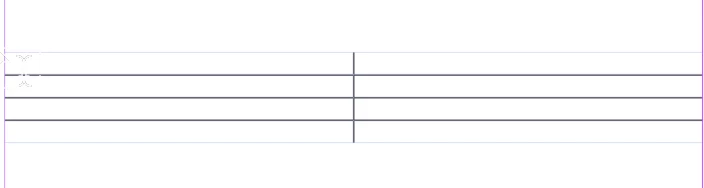

Hi all - I would like to create a table that has no border and no lines on any of the cells. I have managed to create one with no border but as of yet, cannot seem to make the lines on the cells disappear.
Any suggestions?

Select the whole table and on top of the screen select all lines in this and set the stroke to 0 pt:

Thanks K'mo! That worked
I thought I had tried that but I was doing something from the Stroke tab and wasn't having very much luck. Working with the table at the top seemed to fix it.
