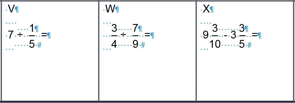

I've been messing around since I posted and have come up with this (goofy) workaround.  Because these are math problems, I created 3 text lines.  The top fraction numbers are on the top line with a -7 baseline shift , the second line is the dividing line (an em dash), the third line is the bottom fraction numbers with a +4 baseline shift.
Here's a screenshot of what it looks like:
It seems to be working (I'm copy/pasting and changing the numbers).
Thank you for your quick-and-dirty idea though!

Your method can work, but I fear ultimately, using spaces that way will let you down. It would be better if you set (center-aligned) tabs for those 6 positions. You'd have better control and and assured consistency equation to equation.
