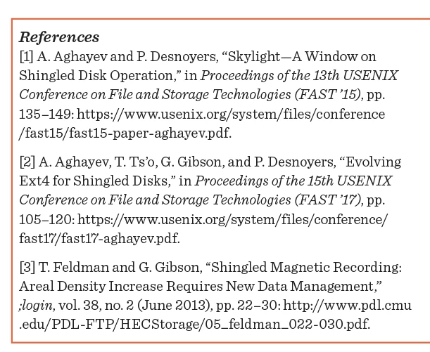

Our technical journal contains a lot of long URLs that break between two lines.
When I attempt to create hyperlinks from these URLS, the result contains a space where the line break occurs, so I have to go back and edit them all manually to remove the space so the link will work in the exported PDF. This is extremely time-consuming and annoying and I don't want to do it!
For example, this text:
https://www.usenix.org/system/files/conference
/fast15/fast15-paper-aghayev.pdf
Creates this hyperlink:
https://www.usenix.org/system/files/conference/fast15 /fast15-paper-aghayev.pdf
Here is an example of what the formatted text looks like.
I have tried letting Acrobat create the hyperlinks from the URLS, but I get the same result, a space in the hyperlink where the line break occurs.
Does anyone have any suggestions for me?
Correct answer Raphael0101
There might be an easier solution for you and anyone who had this issue, like me. Just put the URL between < >. It worked for me

May 2, 2017
I do! Try our https://www.id-extras.com/products/hyperlinkpro
Hyperlink Pro | Id-Extras.com
Sounds like it's tailor-made for people like you :-)
Ariel
id-extras.com | InDesign tools & scripts for typesetters, form designers, and translators
May 2, 2017
Thanks, Ariel, I will test this right away.
May 2, 2017
I downloaded the free version as a test. I had to go through and remove the forced line breaks I inserted, but once I did that, it worked fine.
I assume I can change my forced line breaks to discretionary line breaks with a grep find/change so I don't have to remove them all.
I'll test this a bit more, but it looks like it might be just what I need.
