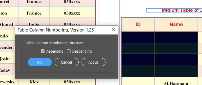

@Laubender  , Thank you, I Fixed the Script (Now no Erros) all Error Conditions Covered
In Case Some One want to Benefit , here the final main script , Thanks you all :

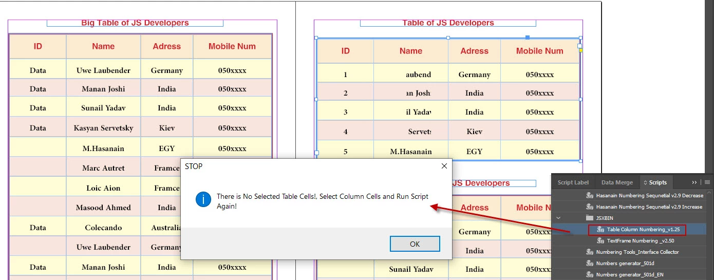

M.Hasanin
M.HasaninAuthor
November 19, 2021
ok, thank you @Laubender , i already made a warning alert to the user to show him to select only column cells to numbering, but i wonder can i prevent user from selecting anything execpet one column direction?
Script only run in case user select cells :
Script will stuck if the user select non column cells, i mean not one direction but indesign didnt crash (images from InDesign 2021)
Mohammad Hasanin

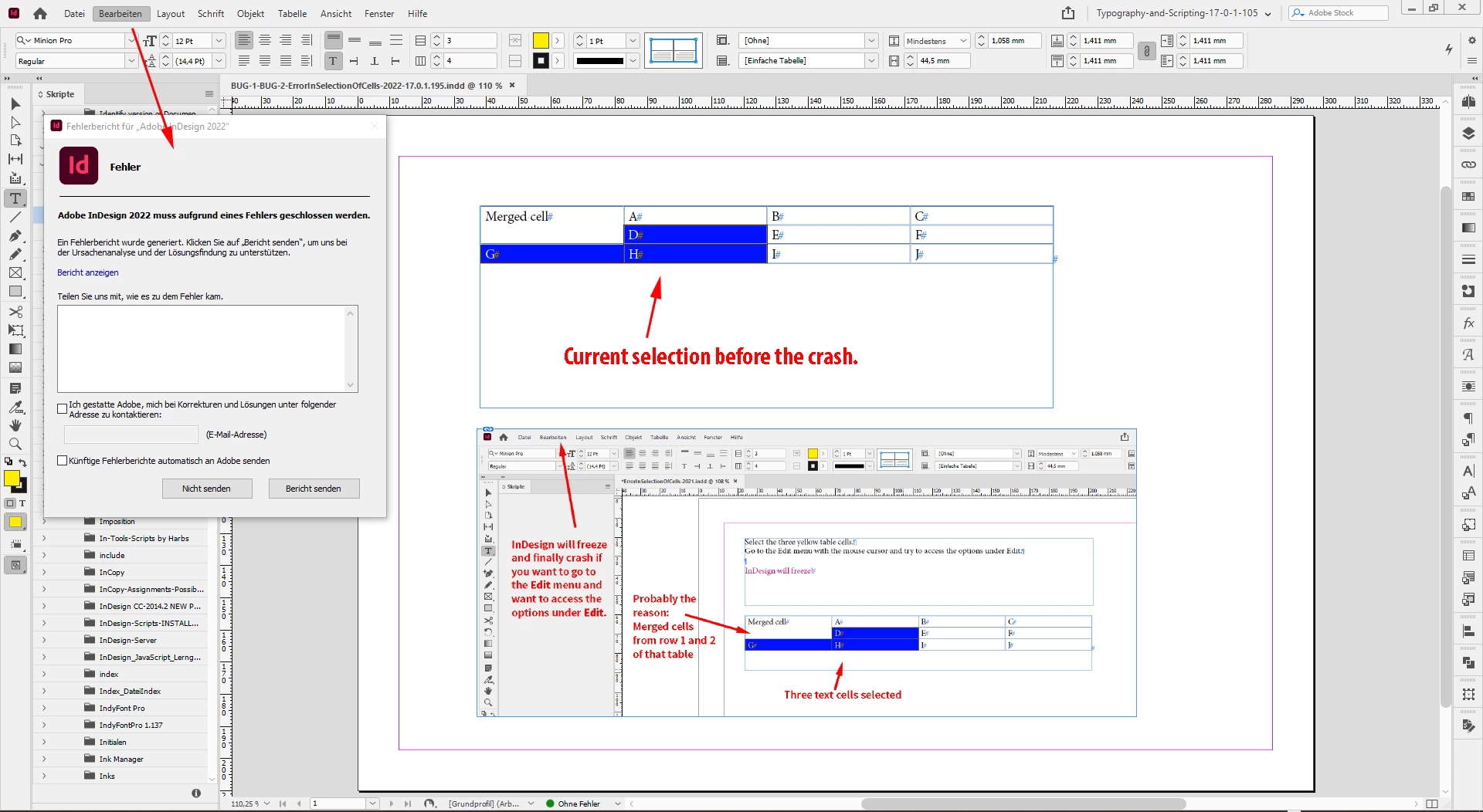

And there is another issue with a selection of text cells like the one above:
InDesign will crash if the above cells are selected and you want to access the "Edit" main menu ("Bearbeiten" in my German InDesign ).
FWIW: The two bugs are already reported at InDesign Prerelease.

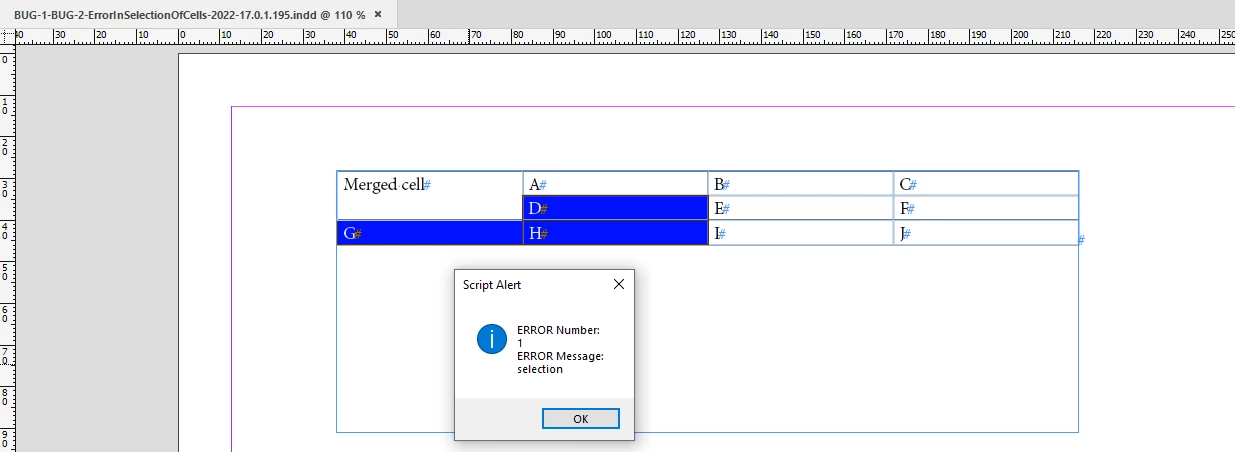

Hi M.Hasanain,
please note that a user could select table cells that a script has trouble with.
Could happen with situations where merged cells are in the table, but not necessarily selected.
try
	app.selection
}catch(e)
	alert
		"ERROR Number:" +"\r"+ e.number +"\r"+
		"ERROR Message:" +"\r"+ e.message
will throw an error when you select the yellow cells in this example:

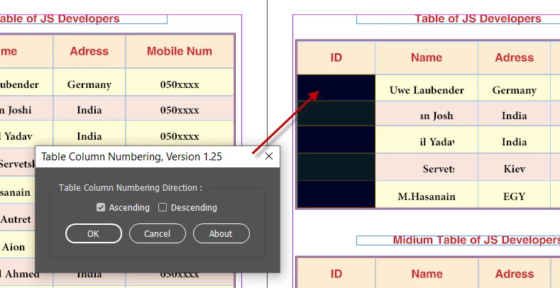

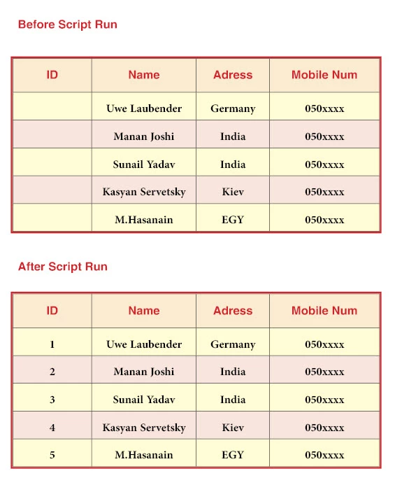

November 16, 2021
Hi M.Hasanain,
could you show in two screenshots what you like to do?
First screenshot: Table cells selected ( perhaps also with contents )
Second screenshot: Result after script run
Uwe Laubender
( ACP )
M.Hasanin
M.HasaninAuthor
November 17, 2021
Dear Uwe Laubender
Thanks a lot for your reply, here is the screen shots in one image, The First Row is Header :
Mohammad Hasanin
