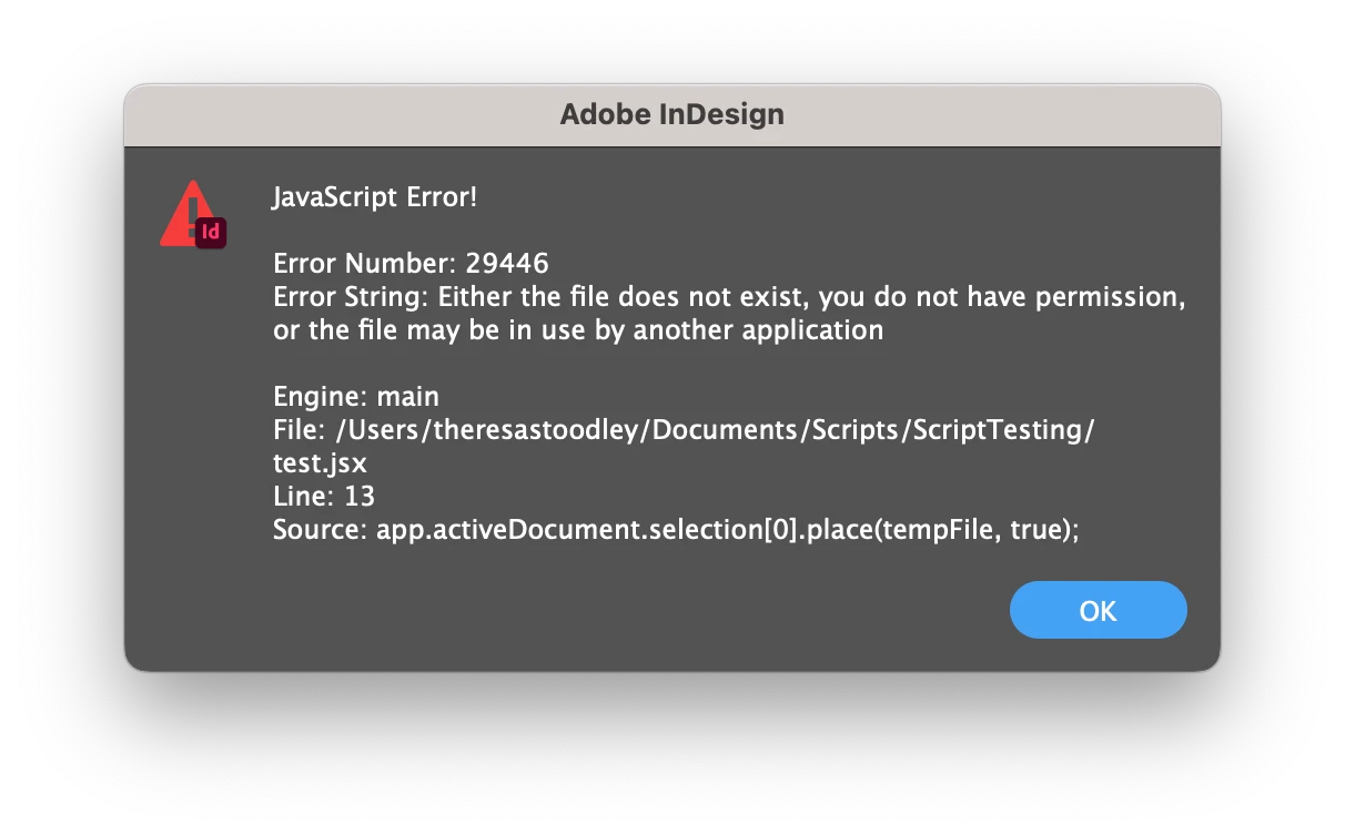

I am trying to understand the behavior of a script I wrote.
The goal of this sample is to generate a temporary text file and then place it in a text frame. I understand that there are significantly better ways to move a string into a text frame, but I want to understand why this in particular is not working.
On the first run, I get error 29446 saying the file does not exist, I do not have permission, or it may be in use by another application.
On the second run—after the file has clearly been generated—it works fine.
I checked to see if the file exists, and If I could open it via the script before placing it with the following snippit.

Please help me understand why the place function is being disagreeable with my file.

This is a bit random for me. If the file does not exists then it creates the file and places it fine, after that the script runs fine again multiple times. However, after multiple runs if you delete the text file and then run the code, it fails quite often with the file in use error though it creates the txt file. I tried adding in sleep and also removing the file before opening it so that a fresh file is created everytime but still it doesn't work. However, if I created a unique file name each time it worked fine.
