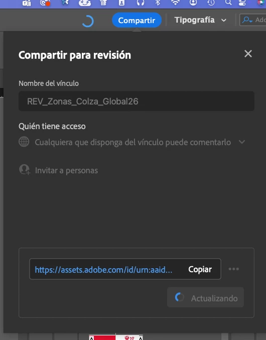

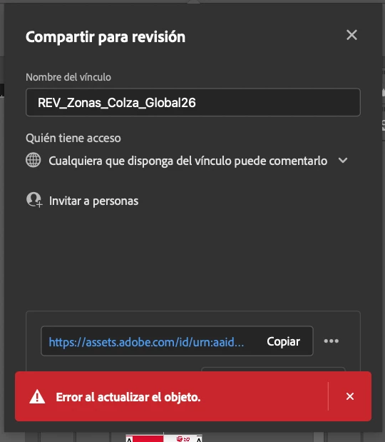

I am experiencing a persistent "Error updating links/artifact" when trying to update an existing Share for Review link. I need to keep the current URL to preserve existing client comments, but the update fails every time with a generic error message.
I have inspected my UXP logs and found a specific HTTP 400 (Bad Request) error. Here is the relevant snippet: [Error] [console] Unknown error getting asset with cloud ID SAMError: [UNKNOWN] Unexpected response status: 400 for https://platform-cs.adobe.io/content/directory/resolve?id=xmp.did:1937be00-1b1b-49fd-a2ff-1b62346e8a9c

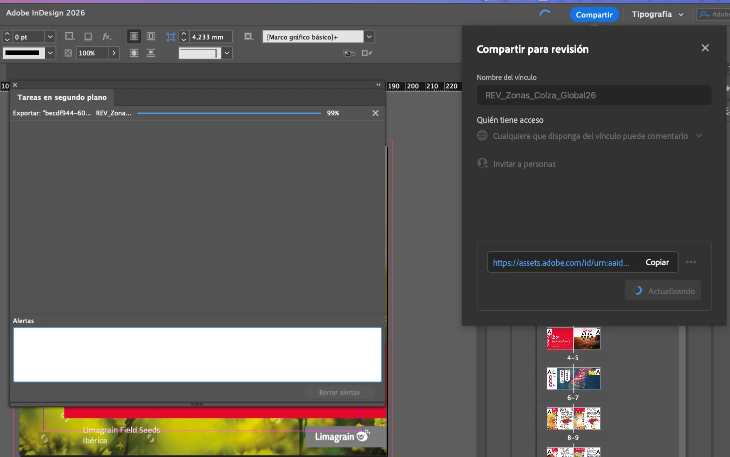

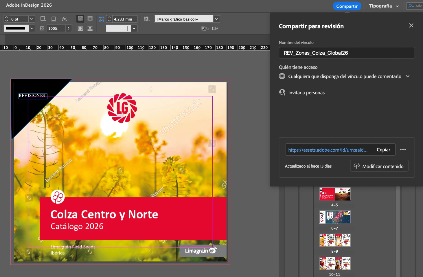

Our team of two enterprises, involving at least three departments, has been using the Share for Review feature successfully since its launch. We manage very heavy InDesign files with complex cross-references and a large number of images, and it has worked perfectly until now.
Following this issue, and after trying several troubleshooting steps (updating, clearing caches, system restarts, etc.), we created a specific, simplified file. We exported our original print layouts to PDF/X-1a and placed them into a clean InDesign file to avoid any potential interference. It worked for the first few days, but then stopped working for no apparent reason and eventually broke the entire review system. Here are the latest log and

1. Workflow Context: I am working on a complex technical document titled "REV". This file contains was created with single PDFx1a. The "Share for Review" link was working perfectly until recently. My goal is to update the existing link to maintain the feedback loop and preserve all comments previously made by stakeholders. Creating a new link is not a viable option as it would fragment the review process.
2. The Specific Error Behavior: Every time I click "Update Link" in the Share for Review panel, the progress bar initiates but quickly stops, showing a generic "Error updating links" or "Error updating artifact" red banner.

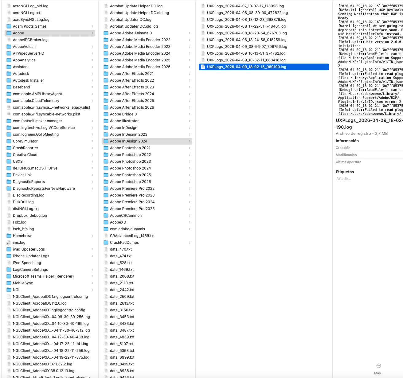

3. Deep-Dive Log Analysis (The "Smoking Gun"): I have inspected the UXP logs located at ~/Library/Logs/Adobe/Adobe InDesign 2024/UXPLogs... (noting that InDesign 2026 is incorrectly writing logs to the 2024 folder). The logs show a consistent HTTP 400 Bad Request when the application calls the Adobe Platform API:
  • Endpoint: https://platform-cs.adobe.io/content/directory/resolve
  • Failed ID: xmp.did:1937be00-1b1b-49fd-a2ff-1b62346e8a9c
  • Result: artifactUpdate failure status for the specific asset ID urn:aaid:sc:US:2b61c263-aa20-4bf9-a872-70744038f35f.
