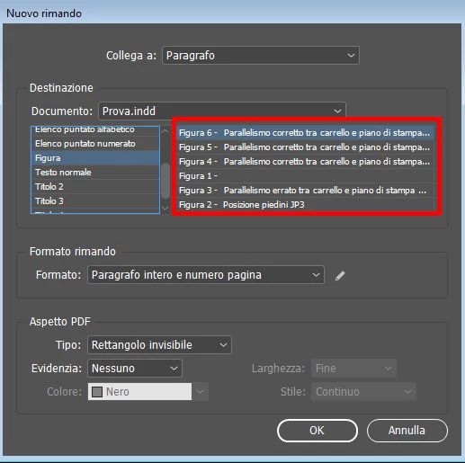

Good morning, I have a question regarding the management of the Cross-references on Indesign CC17.
In my document I should insert various Cross-references to figures (for example) and to do this I created the Paragraph style "Figure", which I use in the
captions of the images; when I click on "Create New Cross-reference", the appropriate window opens, I select my Paragraph style "Figure" and all available choices are shown (Figure 1...., Figure 2...., etc...).
My problem is right here because Indesign makes me view the choices in chronological order of creation and not in growing numerical order; in this way, for example, it happens that figure 1 (which happened to have to be added later) is shown in the list after figure 6. In this way, having a large number of figures that do not follow an ascending order, the insertion of the Cross-reference becomes quite difficult.
Even in the case of Cross-references to paragraphs, they are not proposed to me in a growing order but of creation.
Would anyone be able to explain how to modify the shown order?

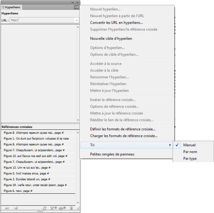

    AFAIK, by default, cross-references are supposed to be sorted by name (meaning "alphabetically")...
    No way I can manage to have them sorted by ID (meaning "chronologically") like in your screenshot.
    To me, it looks like a bug and maybe Troubleshooting 101: Replace, or "trash" your InDesign preferences would get it solved.
    However, you CAN sort the cross-references panel by name or manually (which would be ID by default). You could check "by name" is selected in the CR panel? Maybe there is some sort of relation between the 2 panels... Again, I don't see this happening in my CS6 version, but who knows... maybe a CC2017 bug?

    J'ai bien compris la question, mais personnellement je ne vois pas comment les cibles pourraient être triées par ID comme sur le screenshot présenté.
    Ça me semble être un bug, mais toi qui bosses sûrement sur CC2017, tu peux peut-être me confirmer ce comportement...
