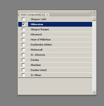

   I'm trying to use WListBoxComposite SDK sample to modify TreeView and add CheckBox for each TreeNode. I changed resource file:

I know that method TreeViewWidgetMgr::ApplyDataToWidget uses informations from WLBCmpNodeID class which represents data of tree node. I tried to add a variable to this class which is refering about checkbox state (selected/unselected). But now I have problem to get information in checkbox observer to get NodeID to save state of checkbox in node ? Please could you help me with this problem ?

Matching your example:
write and implement a SoccerClubMgr interface.
Aggregate that on the appropriate boss - e.g. kDocWorkspaceBoss if its data is persistent per document. In that case you'll also have to consider the whole shebang of own commands, notifications, suites, selection observer, preferences ...
If you load the clubs from a flat file or external database, for laziness sake you could even aggregate the interface in the tree boss, or on gSession.
That SoccerClubMgr would have int32 GetClubCount(), GetName(int32), bool GetFlag(int32), SetFlag(int32,bool) methods, or QuerySoccerClub(int32) if you store them as separate boss. In your TreeViewWidgetMgr, you then use a private QueryClubManager() method to find the interface, then invoke the methods. Or use an additional Util<> class for another level of wrappers.
With this approach you can even reuse IntNodeID to store those int32 index values, rather than creating your own NodeID.
Dirk
July 21, 2009
Don't populate the Tree from resource.
Your TVWM is used to create widgets with its CreateWidgetForNode(), after the ITreeViewHierarchyAdapter is asked for the number of nodes. Each node widget's sub widgets (cbox and text) is populated by ApplyNodeIDToWidget(). When you scroll it out of sight, the node widget is reused for a different NodeID, thus you have to change the name every time you're asked.
For the same reason your backing storage for the cbox also is the ClubMgr - as soon the widget is out of sight it is gone. You have to observe changes and immediately store them in the ClubMgr.
Dirk
