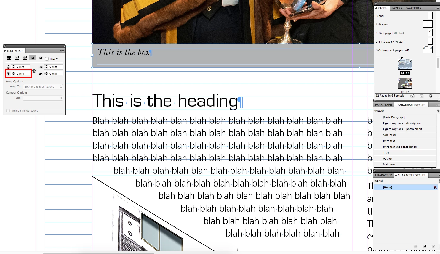

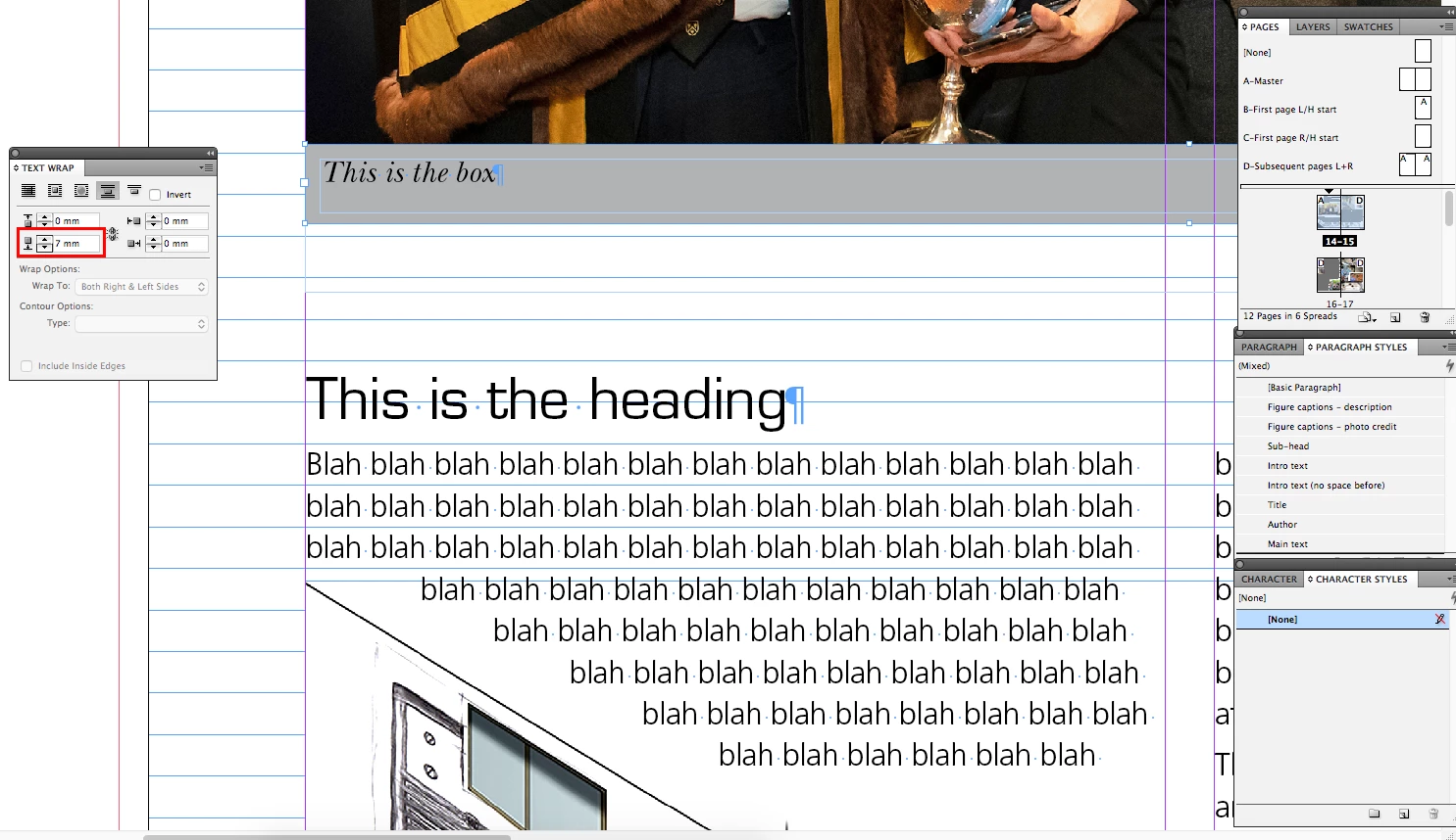

I have a weird problem where I have a heading paragraph following a box (which is not part of the text flow) and I can't get the paragraph any nearer to the box - it's currently >5mm away. The box has no text wrap on the bottom. When I add text wrap to the bottom of the preceding box the paragraph below doesn't move, until I get to a particular amount of text wrap (6mm) and then suddenly the paragraph jumps down. It's like the text has to move down one whole line rather than just however much the text wrap amount is, but the paragraph is not aligned to any grid. Also the text box has no vertical justification - it's set to "Align top". Can anyone suggest what the issue is?
I need to move the paragraph nearer the box above it and I just can't  get it to! There is no 'Space Before' on the para in question.

Thanks all. I did as Barb suggested - turned the Baseline Grid on in the View settings and the paragraph in question (none of them in fact) are aligning to it. Ditto the document grid. As per Uwe's suggestion I checked the text frame's properties and the Basline Grid options are turned off/unticked.
I have uploaded some images to demonstrate what's happening - the box above having 0mm text wrap, the box with 6mm text wrap (no change) and then the box with 7mm text wrap (big jump).
