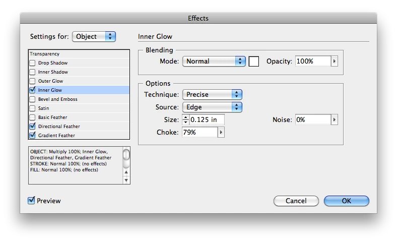

I am having trouble applying transparency to some ovals I'm creating with a script. I've used script in the past to apply drop shadows but this seems a little different. I'm trying to apply Feathering and Glows and I just can't seem to figure this out. The current script I am running does some basic document preperation and the ovals are going to be used by the person who builds the page. If you could help me apply the inner glow, hopefully I will be able to figure out the feathering. Thanks for any help in advance.
The Inner Glow Presets:

Correct answer milligramme
Hi
I think you should use ObjectStyle!
create an Object Style and set some transparency settings, and apply this to objects
var my_obj_style; try {    my_obj_style = myDoc.objectStyles.add({name:"inner glow setting"}); } catch(e){   my_obj_style = myDoc.objectStyles.item("inner glow setting"); } with (my_obj_style.transparencySettings.innerGlowSettings){   applied = true;   blendMode = 1852797549/*BlendMode.NORMAL*/;   opacity = 100;   noise = 0;   effectColor = "Paper";   technique = 2020618338/*GlowTechnique.PRECISE*/;   spread = 79;   size = '0.125in';   source = 2020618594 /*InnerGlowSource.EDGE_SOURCED*/;  } //Create the ovals and specify their size and location... var myLeftOval = myPage.ovals.add({geometricBounds:[2, -3, 2.75, -.75], fillColor:myDoc.colors.item("25% Black"),strokeColor:myDoc.swatches.item("None"), itemLayer:myDoc.layers.item("New Layer"),appliedObjectStyle:my_obj_style}); var myCenterOval = myPage.ovals.add({geometricBounds:[3, -3, 3.75, -.75], fillColor:myDoc.colors.item("25% Black"),strokeColor:myDoc.swatches.item("None"), itemLayer:myDoc.layers.item("New Layer")}); var myRightOval = myPage.ovals.add({geometricBounds:[4, -3, 4.75, -.75], fillColor:myDoc.colors.item("25% Black"),strokeColor:myDoc.swatches.item("None"), itemLayer:myDoc.layers.item("New Layer"),appliedObjectStyle:my_obj_style});

Hi
You can get current value of inner glow settings with this snippet in javascript console.
var obj=app.activeDocument.selection[0];
$.writeln(obj.transparencySettings.innerGlowSettings.properties.toSource().replace(/,/g,",\n"));
And then, edit value what you want.
You can edit other transparency settings like this.
with (obj.transparencySettings.innerGlowSettings){
  applied = true;
  opacity = 100;
  noise = 0;
  spread = 79;
  size = '0.125in';
Thankyou
mg.
