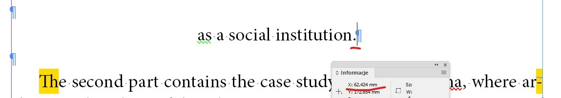

I didn't check everything but thanks for your support.
For example, when text is centred, the value is measured from the first glyph, not from position 0 mm of a text frame. After running your script I get 28.8480614980062 but it should be 62.424 mm:

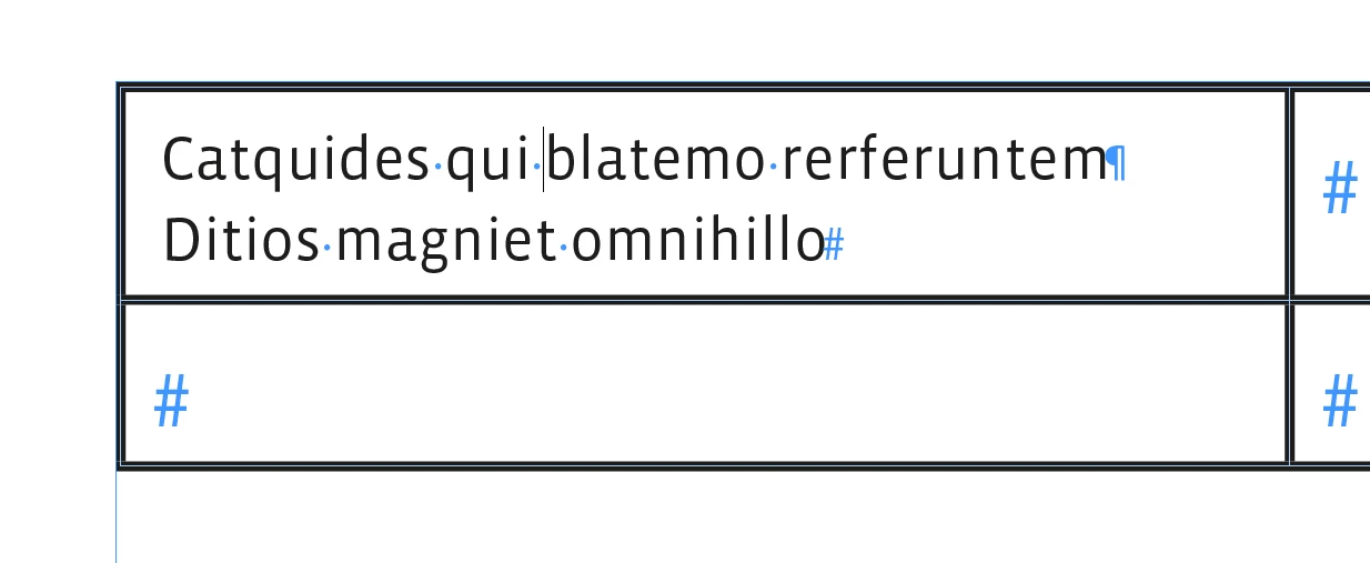

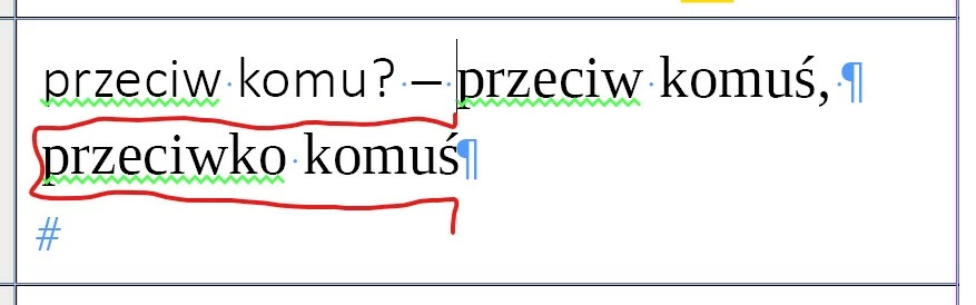

@Laubender I thought it would be very easy to "extract" this value from the Info panel with just one script line but I see now it is quite complicated. That is why I didn't write that everything is in tables. Very sorry for that! In an attachment I've marked what needs to be done. I have 1000+ tables with similar alignments but the text isn't exactly the same in each table. I know it can be done with tabs or with manual alignment but either way I need to know the X value.
@Charu Rajput Your solution is very good and works great for text frames but I didn't mention that everything is in tables. Sorry! Is there a solution for that?
All I need is to tell InDesign to align the second line to the insertion point in the first line:

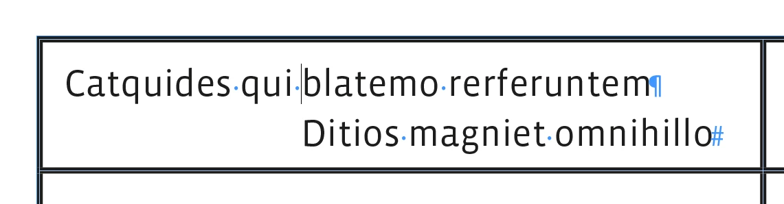

rob day
June 13, 2021
Try this—sets the fist line indent of the next paragraph to the cursor position:
var ip = app.documents.item(0).selection[0].paragraphs[0];
var fli = app.selection[0].horizontalOffset - ip.insertionPoints[0].horizontalOffset
var s = ip.parent.paragraphs
var np;
for (var i = 0; i < s.length; i++){
    if (s[i] == ip) {
        np = s[i+1]
np.firstLineIndent = fli;
