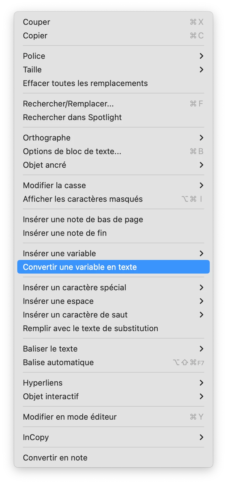

Hi @factoriaediciones Text variables are “seen” as a single character, so you can't apply a character style to a part of the variable. There is a workaround: you can convert a variable to text, then you will be able to aply italics on a part of the (former) variable.

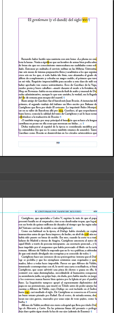

Thanks Anubhav M.
I´ve a problem with the Title of one chapter: if you can see, it has an italic word . I use Headers Text Variables but the italic does not appear at the Header...
Thanks

Sep 4, 2025 4:26 PM UTC
Neither small caps
