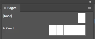

I was hoping, that if you make a Master with 5 pages:
and then when adding new pages, InDesign will use it as a reference for the number of pages per spread - but, unfortunately, it doesn't work that way - 2 pages per spread is hardcoded...
