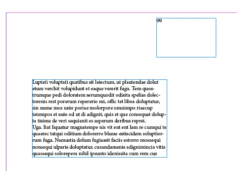

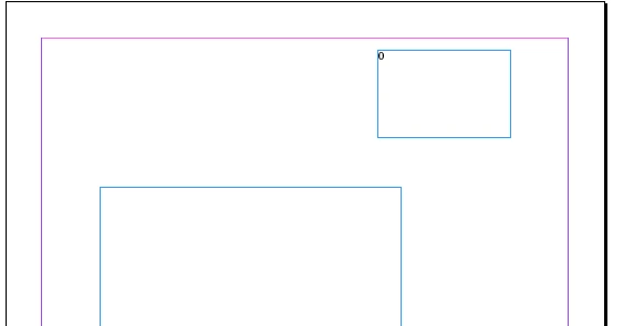

before anything is typed in…
Every time contents is added, counter is updated…
