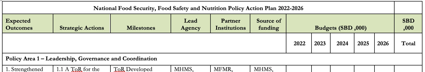

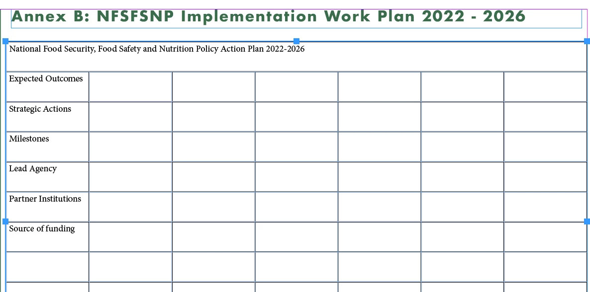

Hi all,
I'm replicating a table from a word doc within an indesign document, that I'm designing for a client in the non-profit sector. The table is about 30 pages long so I need to set it up well from the start so it's less painful for the pages to follow.
Here's the issue, when I copy a ROW of info from cells, then paste into a ROW in my design doc, it pastes everything vertically rather than horizontally. I've researched the heck of this and can't find a solution to this simple problem. See images below.
Any suggestions? I'm not going to place the table from the word doc by the way - too many glitches/messy issues when I tried this.
Thanks in advance!
Cam

I found a solution - the page was rotated, meaning the text was being pasted in the wrong direction. Once I rotated the page, it was fine. I'll complete the table, then rotate the table (not the page). This seems to work.
