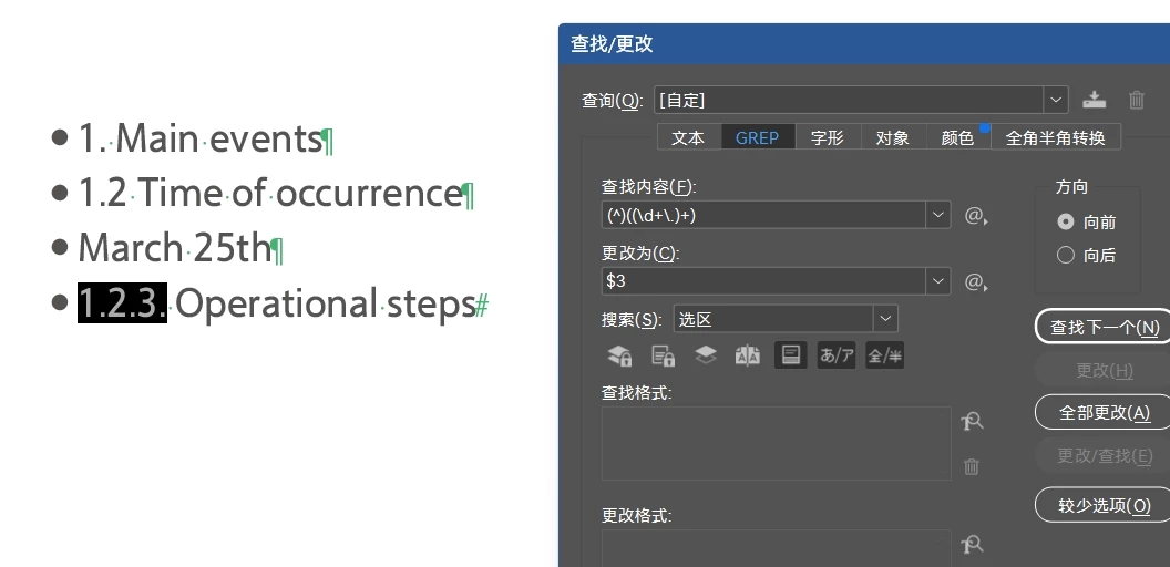

(^)((\d+\.)+) Isn't there one bracket for one group, and does $3 really exist?
When multiple parentheses are nested, are the groups also nested?
This regular expression should only have $1$2. I tried it and it has $3. Isn't $3 empty, or is it an error?
Sample file, I want to search all the numbers
1. Main events
1.2 Time of occurrence
March 25th
1.2.3. Operational steps
Replace with :$3
Found that $3 even exists?

@dublove There is $3 because—as @Barb Binder said—your grep has three capture groups. Your string opens parentheses 3 times. You can "turn off" a capture group by starting it with (?: which creates a non-capture group.

You're right to question how many capturing groups are created. In regular expressions, every pair of parentheses () creates a capturing group, and they're numbered by the order of their opening parenthesis, not by nesting.
Let's break it down
(^)((\d+\.)+)
(^)  Group 1: matches the start of the line (not really capturing anything useful)
((\d+\.)+)  Group 2: matches one or more digit-dot sequences like 1.2.3. or 1.
Inside that:
(\d+\.) → Group 3: matches just one digit-dot, like 1. or 2.
So yes, $3 does exist, and it represents the last match of the inner (\d+\.) pattern.
That’s why when you do a find and replace using $3, it replaces with the final \d+. part inside the repeated group. Even if it's repeated several times (like 1.2.3.), $3 will only capture the last match in this case, 3..
So in your test case:
$1 = start of line (empty string)
$2 = 1.2.3.
$3 = 3.

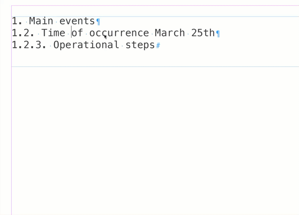

It's a bit messy and slow - because of non-important matches and slow because it needs to replace the found with the change to $3
We can use what we were talking about recently - when you were unsure about the difference between
\> and \b
Here's a perfect case to find these things - and you don't need a Change To
I went one step further - but if it's not what you need we can cut it back but it's just an example and proof of concept.
^(\d\.)+(\d\.)\b
To highlight what's being found - I put in pink for show and tell
With nothing in Change To and hit change all
Again - it's just a demonstration.

Because your have three sets of parentheses and therefore three groups.

You have three groups. Your first group is the position locator: beginning of paragraph. Not sure why you are grouping it. InDesign will add a space for $1 if you leave it grouped. And then when nested groups, the encompassing group is counted first, and the nested one second.

What I'm asking is why there's a $3?
m1b
m1bCommunity ExpertCorrect answer
May 24, 2025 6:57 PM UTC
