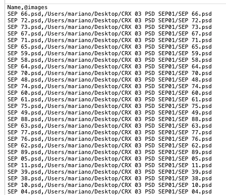

Why would the CSV file used in Data Merge when auto-importing images from a folder be ordered randomly?
I have a folder of images named: SEP 01.psd, SEP 02.psd, SEP 03.psd, etc. but the resulting CSV after running the script looks like this:
I know I can re-order the CSV file but I want to know why is this happening because I've used this script extensively in the past with no problems. I've tried all 3 formats of the ImageCatalog script included in InDesign, plus a custom version I always use, and they all yield the same unordered results.

Thanks to Robert at ID-Tasker mentioning NTFS and file creation order, I've found the source of the problem: it's a file naming and disk format combination issue, not an InDesign or script-related problem
Robert's comment made me take a closer look into disk formats and the files themselves, as everything else seemed right. So I've discovered that even though the files are numbered sequentially in ascending order, they come up arranged by modification date on the resulting CSV. I copied the files from the external PC-formatted drive they originally reside into a new folder on my Mac, renamed all files sequentially again –making sure they are ordered by name and not by creation or modification date– and they are being imported correctly in numbered sequence now.
