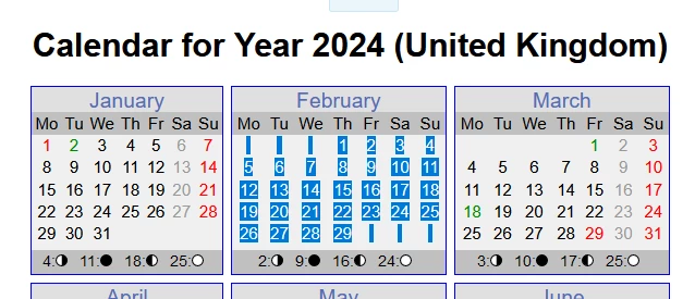

As you are using Tables - so the only option is to replace contents of those tables... Much quicker than writing script.
You can use any website for days:
https://www.timeanddate.com/calendar/?year=2024&country=9

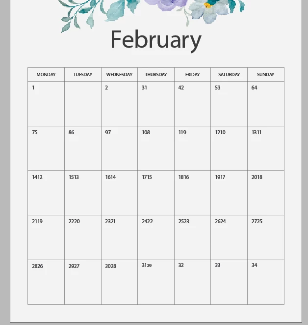

Then copy&paste month by month - but for some reason you have local Numbering turned on:
 ... so you would need to turn it off:
