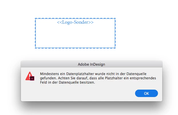

Hey everyone,
im stumbeling over a either totally stupid user-mistake or a decent oversight, but maybe there is a script snippet for this, here is my problem:
I used an old data-merge document, edited some text values, but preview/export won't happen because there are still old data fields…
I checked...and then I saw it: image containers are to blame and were still tagged with values "from the past".
How can I get rid of the imagecontainer-tag and keep the imagecontainer for further use? This seems to be an oversight, if there is no context-menu for that.

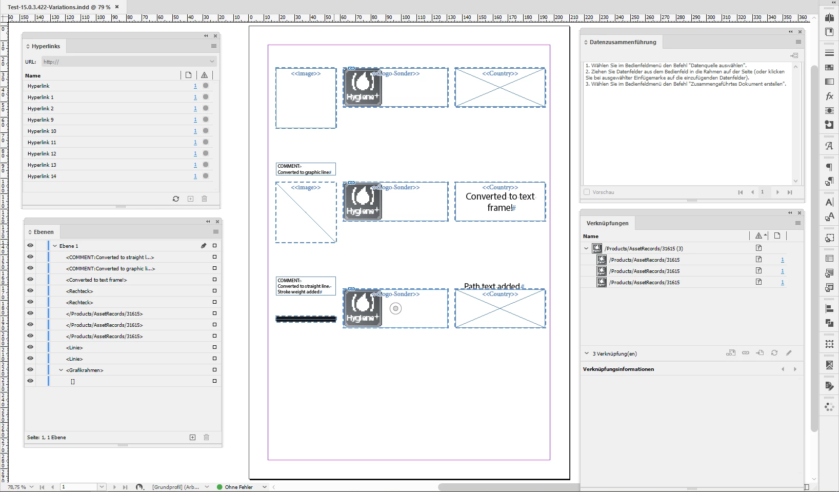

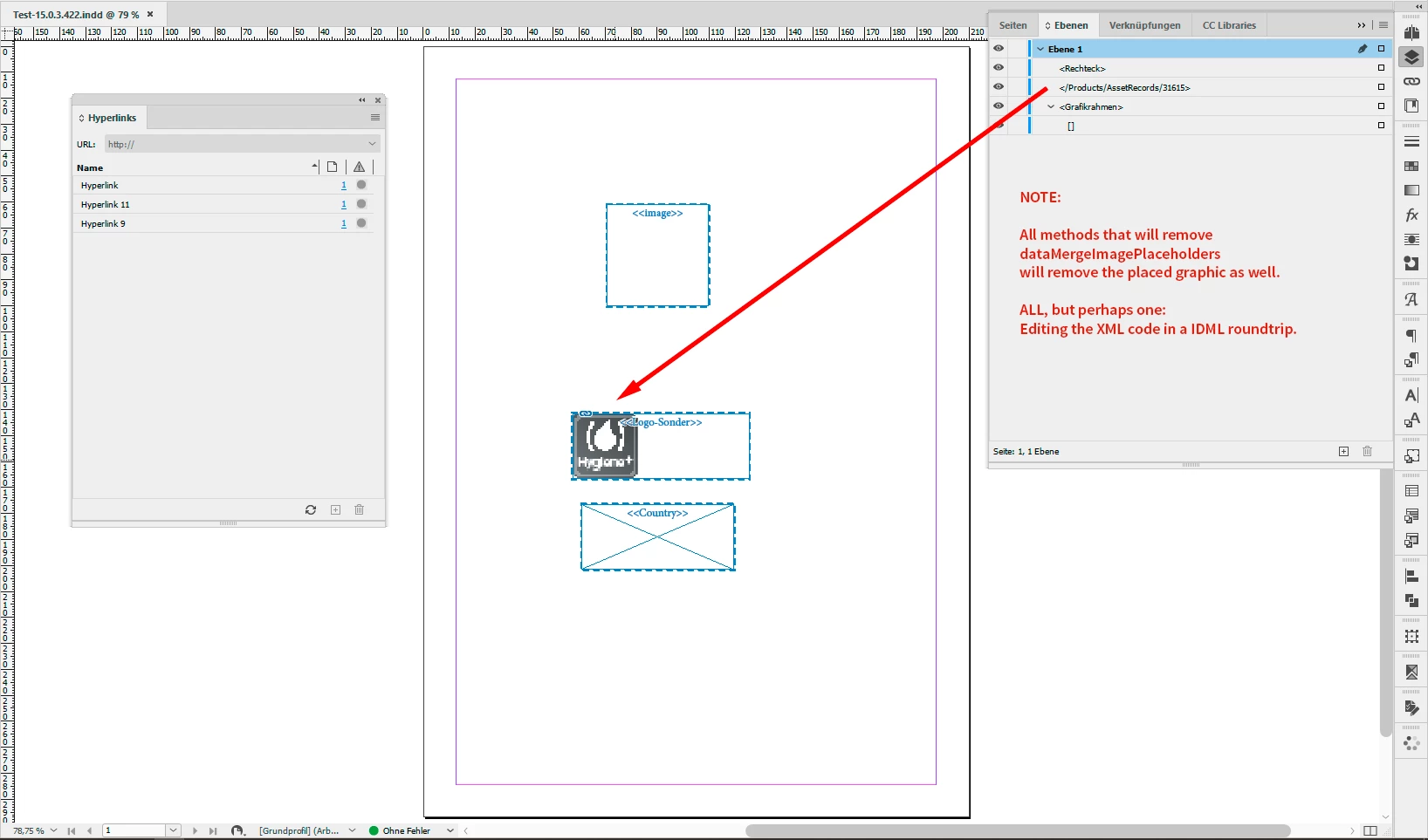

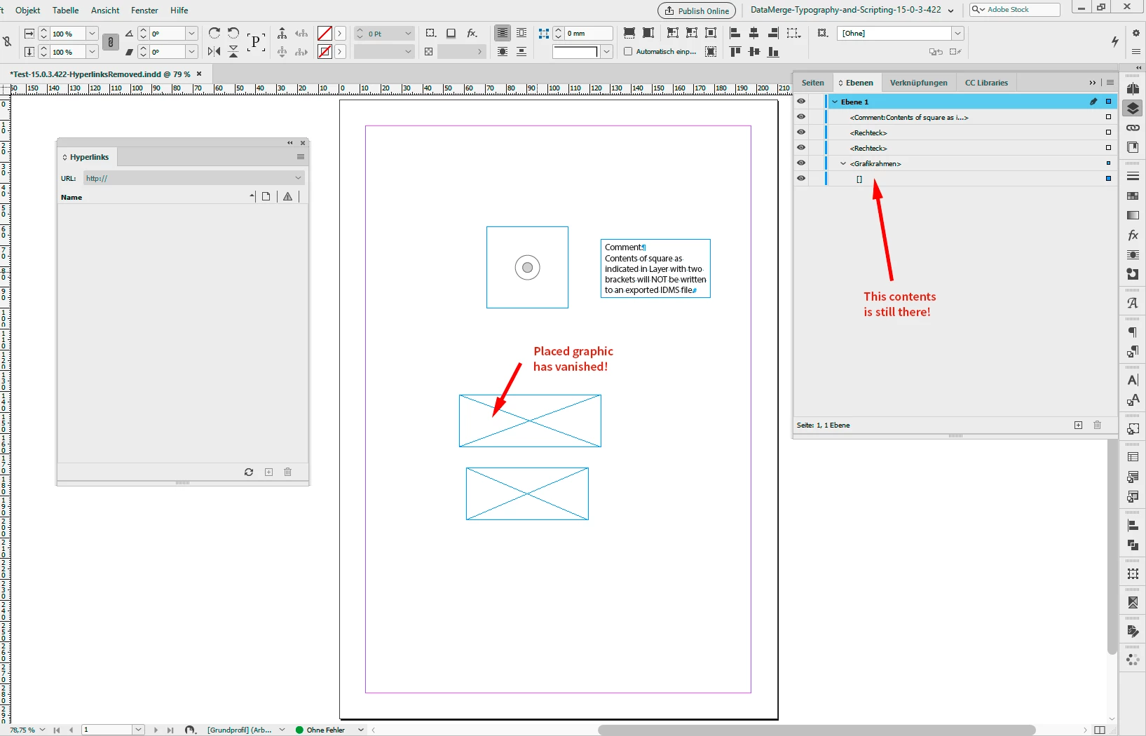

May 11, 2020
Hi Jan,
I spent a good deal of my weekend solving your puzzle.
What you could do but with a couple of flaws, you could remove the corresponding hyperlinks:
Result:
Flaws: Placed graphic was removed as well.
One object, the square, still has a remnant, a double bracket object you can see in the Layers panel:
I went along and tried to write a script that is removing the dataMergeImagePlaceholders.
It turned out that object dataMergeImagePlaceholders has no method remove(). Silly, isn't it?
That lead to further, deeper investigation of the issue. Finally I found a way.
I will not share the script in the open here. You can contact me with a private message, if you are interested.

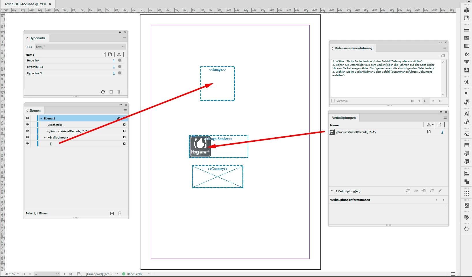

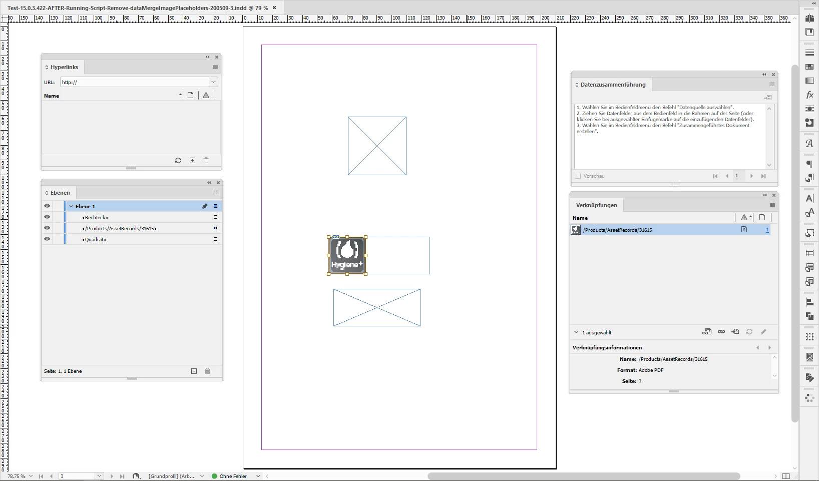

Before running the script:
The result after running the script:
Still, there might be some cases where the script is not working. No idea if you have other samples that look like that:
For testing the script and debugging I need the real document.
Not only three sample frames.

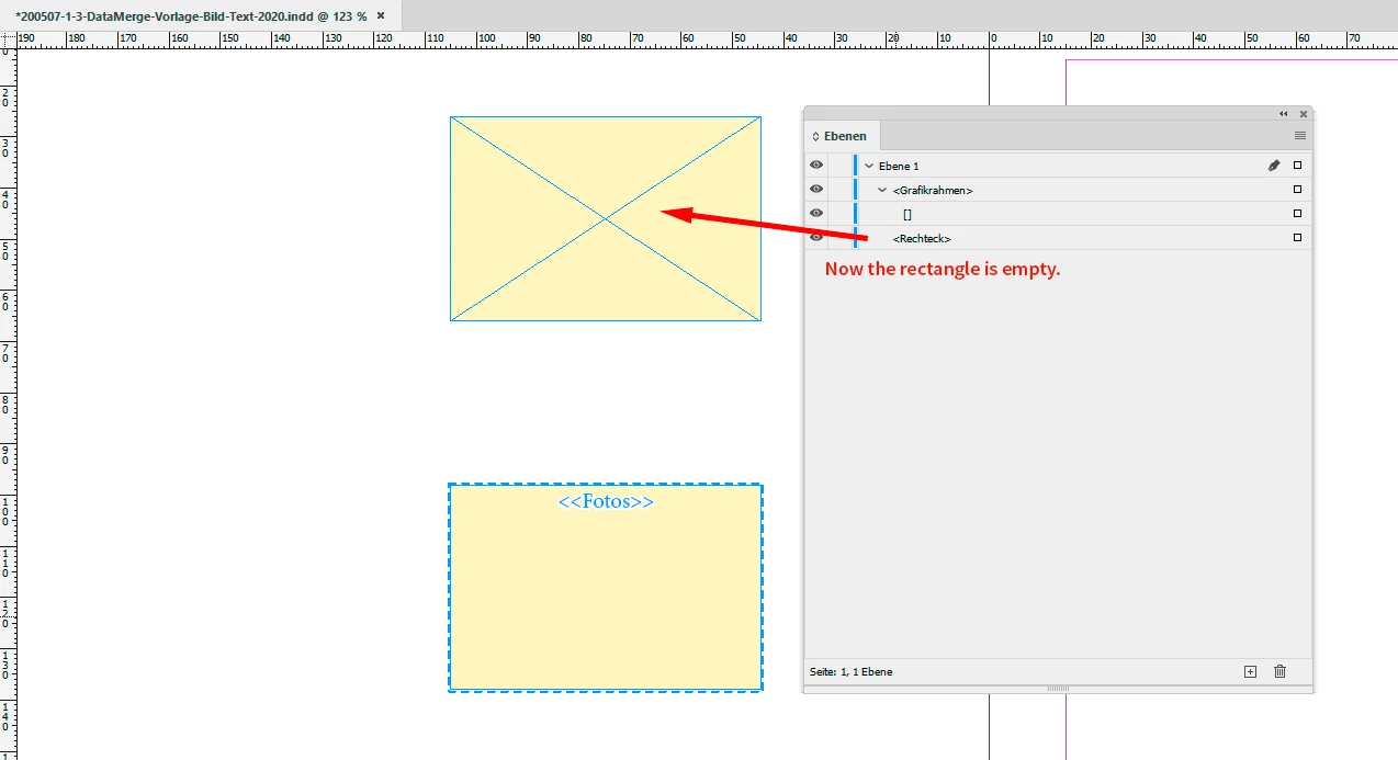

May 7, 2020
Hi Jan,
if you still see the placeholder you did not remove the contents of the graphic frame.
As I said, best do this in the Layers panel.
Contents selected:
Contents removed:
Uwe Laubender
( ACP )

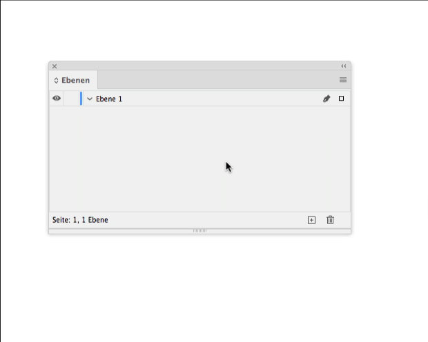

DBLjanAuthor
May 8, 2020
Wow, now i'm confused: My layer-palette doesnt work like yours, and only shows that image-box, and Im unable to expand any arrows in the UI. I usually still work in CC18 (because of a plugin), but I checked in CC20 too:

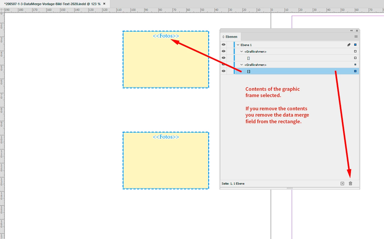

May 7, 2020
Hi Jan,
simply select the frame's contents and remove it.
That's very easy from the Layers Panel:
Select the graphic frame.It's contents should show up like that: []
Uwe Laubender
( ACP )

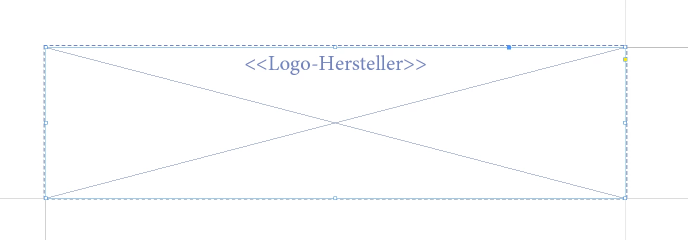

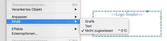

May 7, 2020
Hi Uwe,
good to hear youre well in corona times.
But I think I have to disagree. As you see, i removed the "empty" content, which defines the box-content as <image> (optional <text> or <nothing>). You should notice that the box is not crossed by lines (which indicate a image box).
