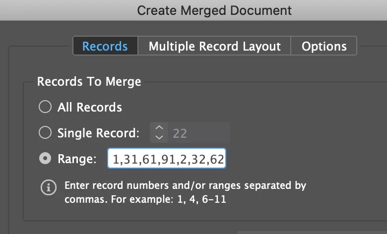

Hi Marty,
in inDesign your options are rows first or columns first per page. The simplest thing to do is run a script to change the rows in your spreadsheet or create a text file (various ways to get the order) that if you need it 4 up as you explained and you have 120 records to run: (i did this with a formula in open office and saved as csv opened as text and grep'd the end of paragraph with a replacement "," and I am sure there are easier ways 1,31,61,91,2,32,62,92,3,33,63,93,4,34,64,94,5,35,65,95,6,36,66,96,7,37,67,97,8,38,68,98,9,39,69,99,10,40,70,100,11,41,71,101,12,42,72,102,13,43,73,103,14,44,74,104,15,45,75,105,16,46,76,106,17,47,77,107,18,48,78,108,19,49,79,109,20,50,80,110,21,51,81,111,22,52,82,112,23,53,83,113,24,54,84,114,25,55,85,115,26,56,86,116,27,57,87,117,28,58,88,118,29,59,89,119,30,60,90,120, and so on then copy and paste into the range dialogue. Indesign will propagate into the stacks you desire. (and yes you can paste large sequence in the field)
that should sort out your dilemma
/G
Grant H
Mar 24, 2021 8:53 AM UTC
I tested it with 400 records:
and it works
1,101,201,301,2,102,202,302,3,103,203,303,4,104,204,304,5,105,205,305,6,106,206,306,7,107,207,307,8,108,208,308,9,109,209,309,10,110,210,310,11,111,211,311,12,112,212,312,13,113,213,313,14,114,214,314,15,115,215,315,16,116,216,316,17,117,217,317,18,118,218,318,19,119,219,319,20,120,220,320,21,121,221,321,22,122,222,322,23,123,223,323,24,124,224,324,25,125,225,325,26,126,226,326,27,127,227,327,28,128,228,328,29,129,229,329,30,130,230,330,31,131,231,331,32,132,232,332,33,133,233,333,34,134,234,334,35,135,235,335,36,136,236,336,37,137,237,337,38,138,238,338,39,139,239,339,40,140,240,340,41,141,241,341,42,142,242,342,43,143,243,343,44,144,244,344,45,145,245,345,46,146,246,346,47,147,247,347,48,148,248,348,49,149,249,349,50,150,250,350,51,151,251,351,52,152,252,352,53,153,253,353,54,154,254,354,55,155,255,355,56,156,256,356,57,157,257,357,58,158,258,358,59,159,259,359,60,160,260,360,61,161,261,361,62,162,262,362,63,163,263,363,64,164,264,364,65,165,265,365,66,166,266,366,67,167,267,367,68,168,268,368,69,169,269,369,70,170,270,370,71,171,271,371,72,172,272,372,73,173,273,373,74,174,274,374,75,175,275,375,76,176,276,376,77,177,277,377,78,178,278,378,79,179,279,379,80,180,280,380,81,181,281,381,82,182,282,382,83,183,283,383,84,184,284,384,85,185,285,385,86,186,286,386,87,187,287,387,88,188,288,388,89,189,289,389,90,190,290,390,91,191,291,391,92,192,292,392,93,193,293,393,94,194,294,394,95,195,295,395,96,196,296,396,97,197,297,397,98,198,298,398,99,199,299,399,100,200,300,400
