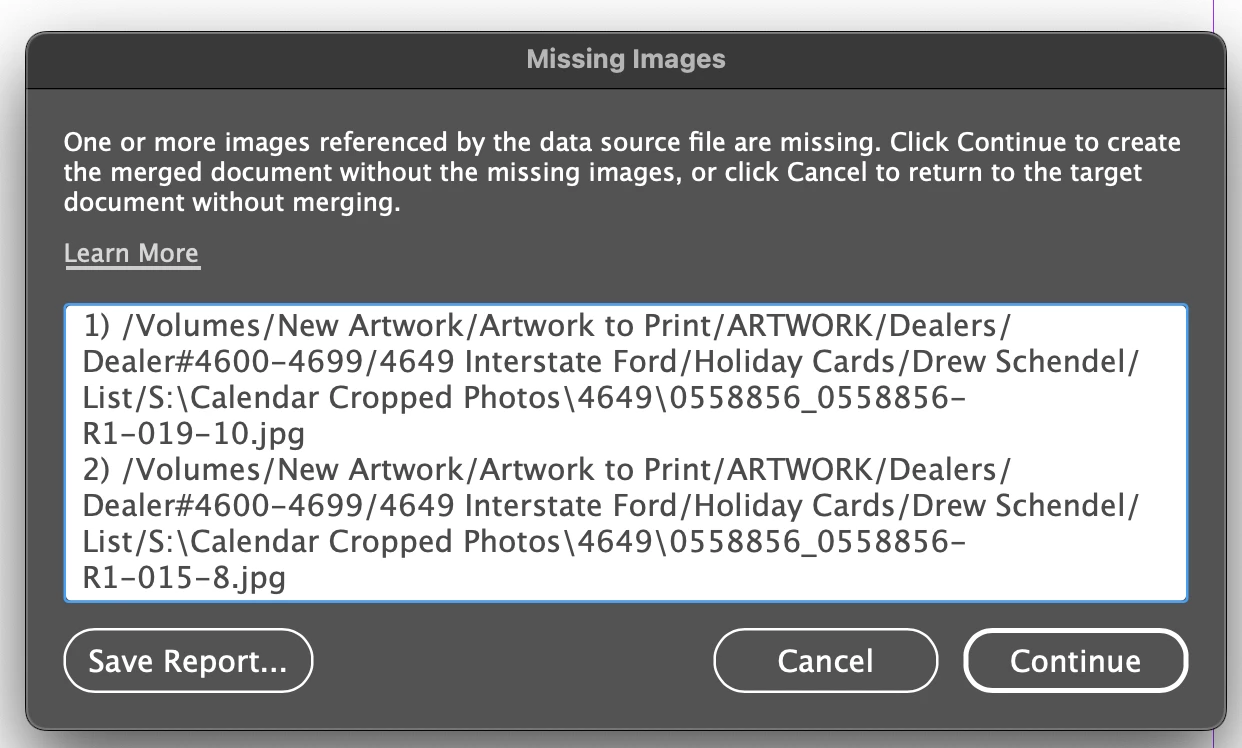

I don't know what is happening. I was able to pull photos in a data merge in the past without issues. But now it's not working correctly.
When it goes to pull the photo location to place the pictures, it keeps popping up that it can't find them because of the source file. It brings up this error:
The first half of that location is where the .csv file is saved.
/Volumes/New Artwork/Artwork to Print/ARTWORK/Dealers/Dealer#4600-4699/4649 Interstate Ford/Holiday Cards/Drew Schendel/List/
and the second half is where the picture is saved.

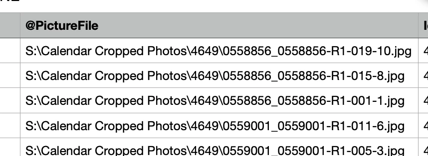

S:\Calendar Cropped Photos\4649\0558856_0558856-R1-019-10.jpg
I don't know why it keeps thinking that they need to be together. I've checked the original Excel File and the CSV file to make sure they were written correctly and they are.

These are not valid Mac paths:
They should start with /Volumes/Photodisk/...
These paths are also not valid at all:
It looks like a POSIX folder path to which is an HFS path to a file is appended.
You must use POSIX paths to your files only.
You can Option-Right click a file in the Finder, then select "Copy as pathname" to get its POSIX path.
To this (the macOS path):
/Volumes/Photodisk/Calendar Cropped Photos/4649/0558856_0558856-R1-019-10.jpg

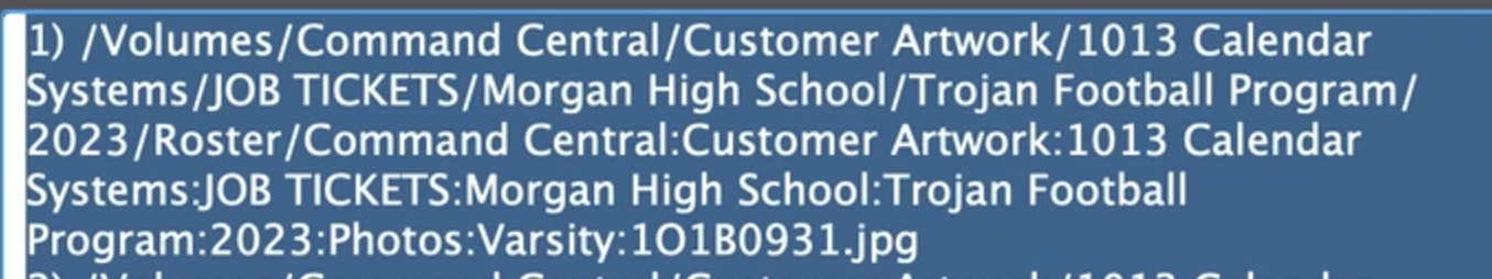

I went back to the file I used a year ago that used this same method. I opened it and immediately tried merging and I get the same error. So I think something broke when InDesign Updated (either this most recent update or if there was an update in the last 8 months or so). So it no longer works on my computer at all. I do not have a PC with InDesign on it that I can try so see if it's a Mac issue. Here is a picture from when I tried with the old file: https://imgur.com/a/pudK7s0

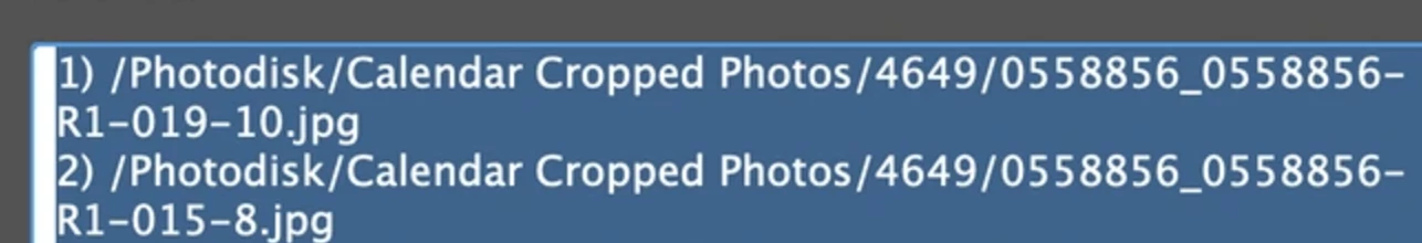

UPDATE: We realized the Excel Sheet was created and originally came from a PC User. And we currently use Apple. So I changed up the file path to match the way Apple can read it. It got us closer. But still not working correctly. You can see that here: https://imgur.com/a/pudK7s0
We tried many different ways to write this. using the actual Server name/number and adding and taking out different parts of the path.
We are no longer getting stuck with the first half as mentioned in the original post, but we can't figure out how to tell it where to go.
