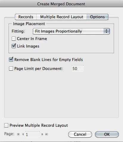

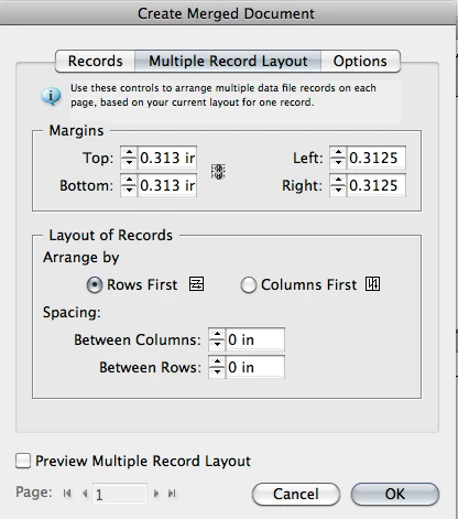

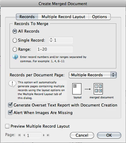

August 15, 2012
Can you include a screen shot of the Multiple Record Layout tab, and the Options tab? The key to the problem may be in one of those.
qpokcAutor
August 15, 2012
That WOULD make sense.... here we go!
August 15, 2012
Everything looks fine there, so my best guess would be a stray item on the page could be throwing things off. If you could post a link to the InDesign file, I could take a look at it. (I will create a dummy data file to test with)
