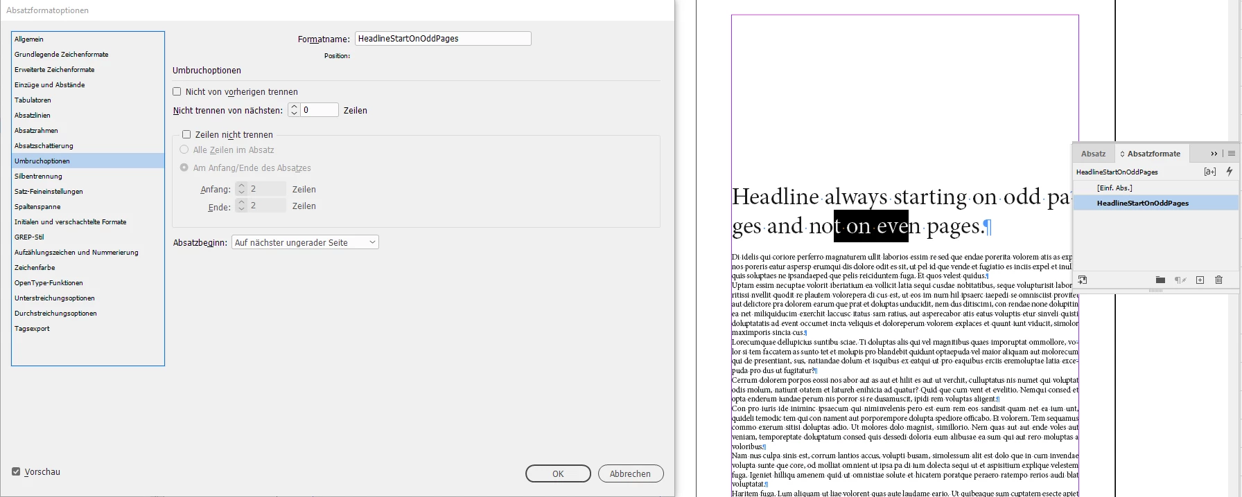

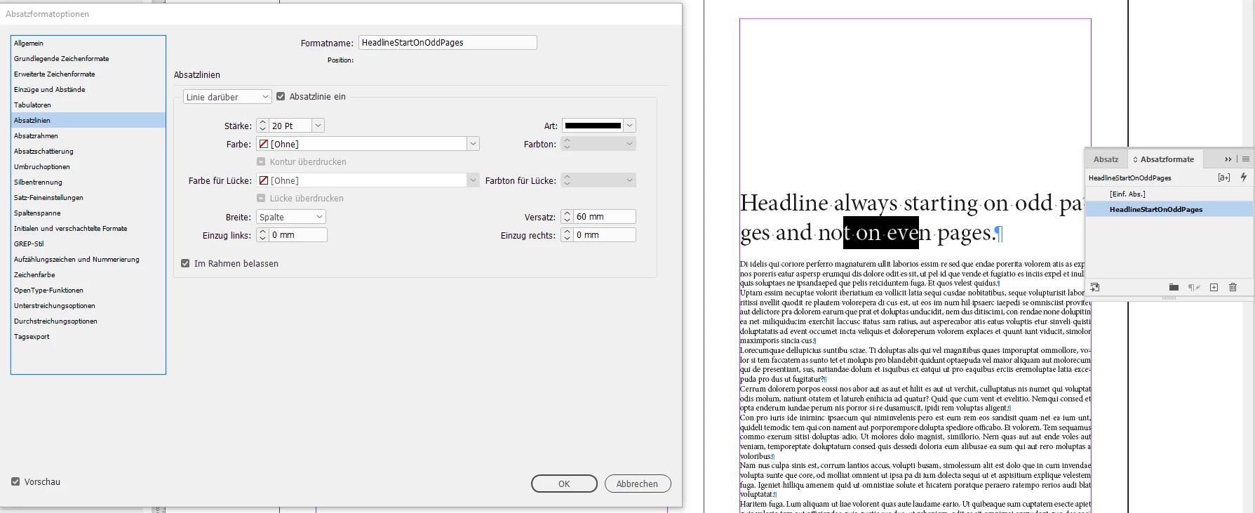

you would need two options to do what you want, all paragraph properties that can be expressed with a paragraph style for the headline:
1. Start paragraph on next odd page.
2. Use a paragraph rule with a high offset value AND check the option "keep rule in frame"

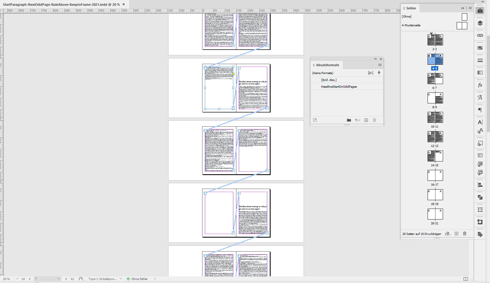

From my German InDesign 2021:
Text flow with a facing pages document where I used this paragraph style two times:
Download the IDML file of this document from my Dropbox and inspect the paragraph style for the headlines:
https://www.dropbox.com/s/jtl5h9x3ka9zuhk/StartParagraph-NextOddPage-RuleAbove-KeepInFrame-2021.idml?dl=1
