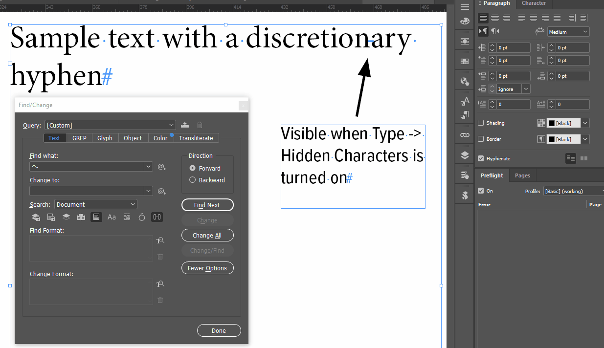

    If you turn hyphenation OFF, discretionary hyphens will not be used.
    I wasn't sure if this was the case, so I ran a little test to determine if the Hyphenation setting determines the behavior of discretionary hyphens:
    Seems that the state of the Hyphenation setting doesn't affect the behavior of the discretionary hyphen.
    If you want to remove discretionary hyphens throughout the document, and they are actually discretionary hyphens and not something else, then you can use the Find/Change dialog and look for -^ and replace with nothing:
    It doesn't matter if the discretionary hyphen is showing or not; the same ^- search will find it.

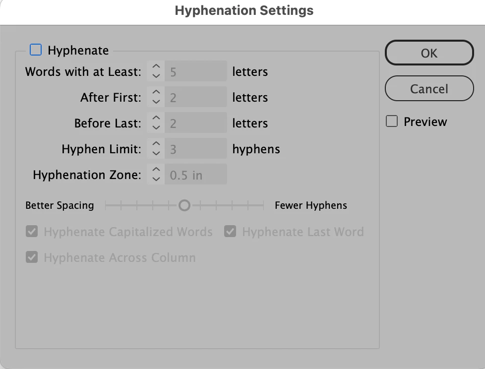

    I think your understanding of "discretionary hyphens" and how they work is incorrect.
    From the Help file: "Discretionary hyphens
    A discretionary hyphen (Type > Insert Special Character > Hyphens And Dashes > Discretionary Hyphen) appears only if the word breaks. This option prevents the common typographic problem of hyphenated words, such as “care-giver,” appearing in the middle of a line after text reflows. Similarly, you can also add a discretionary line break character."
    Hyphenation can be turned off in the Control panel or in Hyphenation Settings:

    Joel CherneyCommunity ExpertCorrect answer
    February 6, 2024
    Steve Werner
    February 6, 2024
    Great discovery - thanks for checking!
