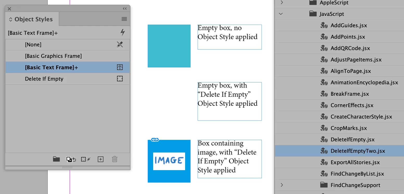

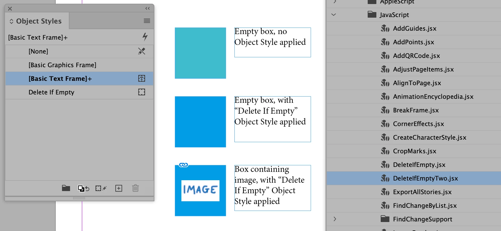

I am looking for an Indesign .jsx script that...
1) Finds all picture boxes in the active document with a certain Object Style applied to them.
2) Then finds all of the above that are empty (ie have no image inside), then deletes them.
Something like this (my apologies for the rubbish attempt at Javascript, I don't know it!)...
// create a variable for finding all objects with the Object Style called "Delete If Empty"
var MyObjectStyle = app.findObjectPreferences.appliedObjectStyles = "Delete If Empty";
// write an if statement so if the frames are empty, delete them
if (MyObjectStyle.GraphicFrame.length < 0;) {
MyObjectStyle.GraphicFrame.delete;
Any help would be most appreciated,
Thank you 🙂

brian_p_dts
January 30, 2024
You'd probably also want to do allPageItems to catch anything anchored or grouped.
Robert at ID-Tasker
January 30, 2024
quote
By @brian_p_dts
Yeah, you are right, I've "ignored" it in the first, test version.
Fixed.
BUT ... it will probably fail - yours as well as you don't have try...catch either - when Group have only two items - like in one of the recent posts?
brian_p_dts
January 30, 2024
Think this should do it.
app.findObjectPreferences = null;
var finds = app.activeDocument.findObject();
var i = finds.length;
while(i--) {
  if (!finds[i].graphics.length) { finds[i].remove(); }

February 2, 2024
Thanks @brian_p_dts - this worked like a charm...
