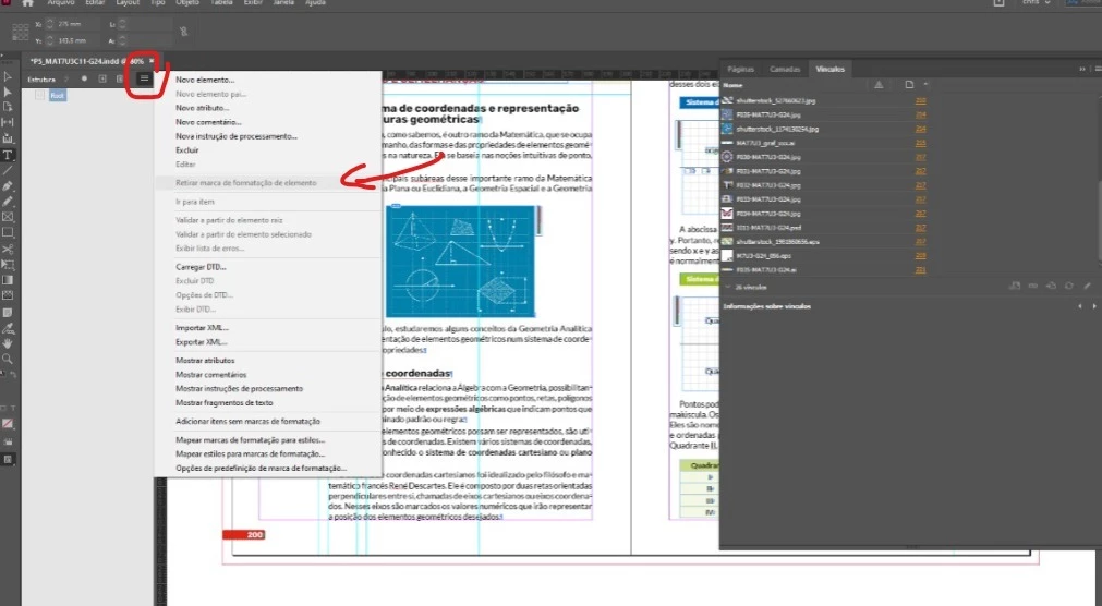

I'm from Brazil, so excuse me for my imperfect English...
ctrl + alt + 1
Click on root when it open, select all archives, click on menu and
Than you can delet ROOT.
All the XML that is not actually being used will be deleted
