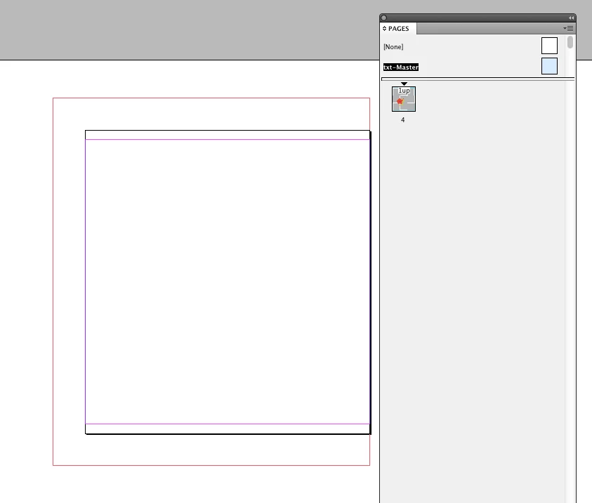

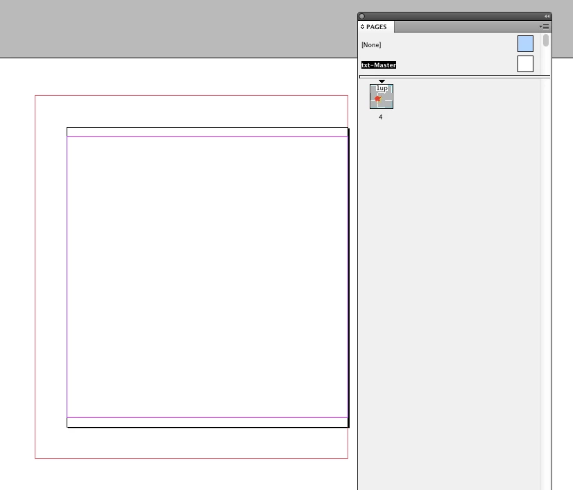

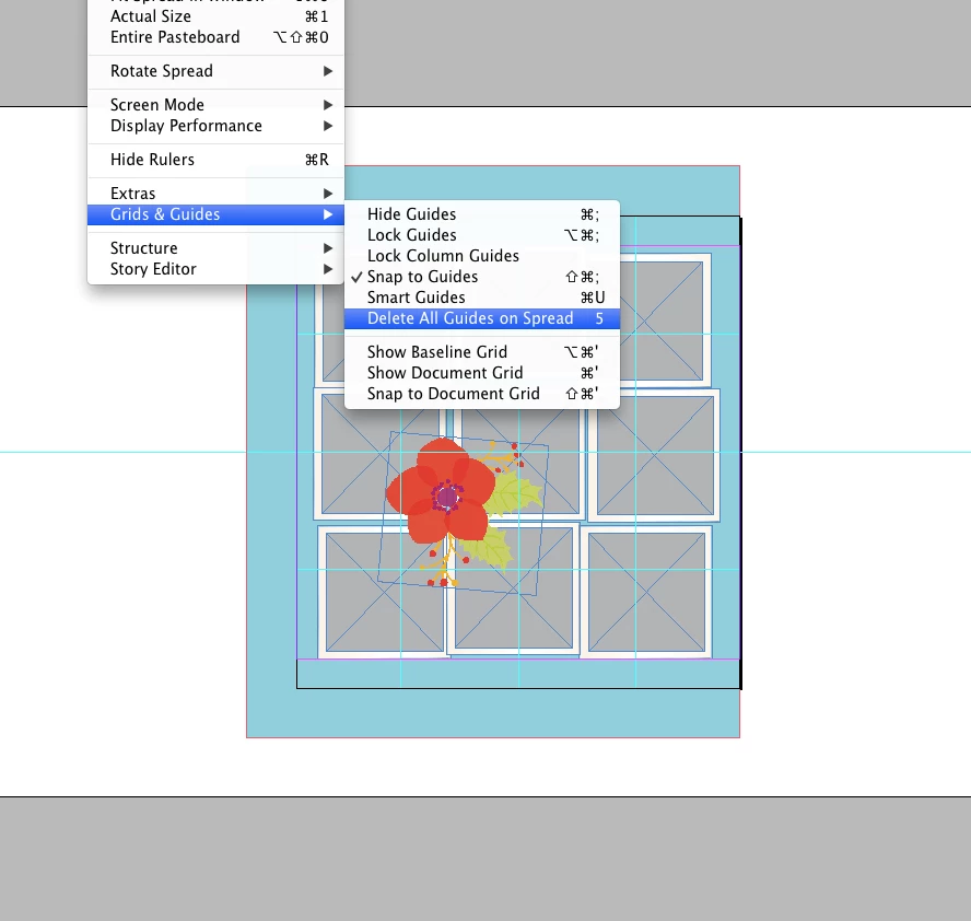

    September 14, 2012
    so guess what, I have found a few files that are behaving the way that prompted me to write. The guides are all unlocked, and there are none on the master pages, but still will not delete. Here are some screengrabs of me checking the master pages and trying to delete the guides. I can provide the indd file if anyone wants to see it. I'm so perplexed. I have two other examples, too.
