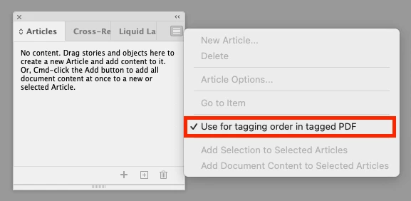

@Jake31240521nz7q The articles panel is a good start. Remember that only what is in the article panel makes it to the tagged PDF. Do not rely on the Reading order that you can check in Acrobat because that is not the reading order that the screen reader will adhere to. Use a tool like PDFgoHTML to check your exported PDF in Acrobat.
So the most important steps in order:
  1. Open the articles Panel
  2. In the Panel Flyout menu check “Use for tagging order in tagged PDF”
  3. Add your objects in the order you want them to be read to the articles panel.

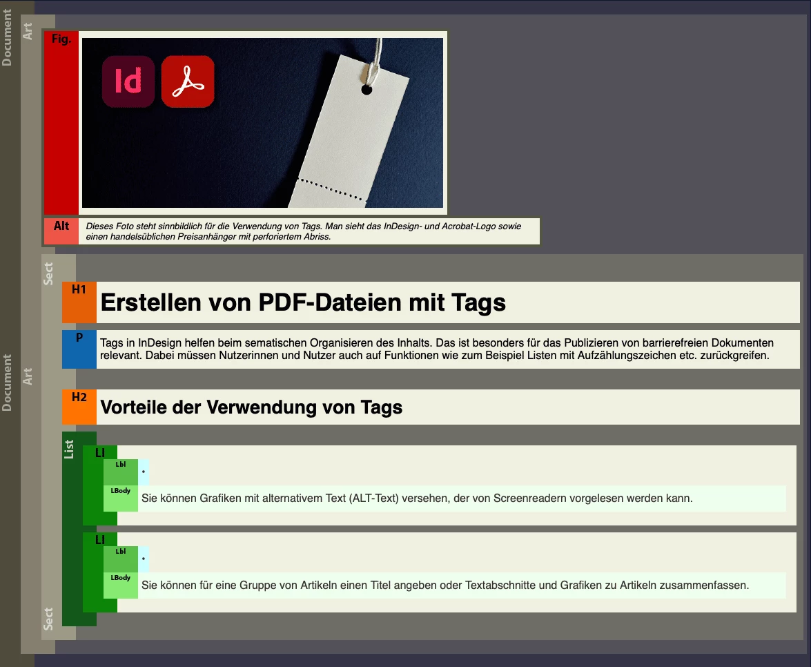

Maybe start with a small selection and check in Acrobat with PDFgoHTML (a free Plugin for Acrobat from Callas). It will look something like this (depending of course which elements and tags you used) …
There is a lot more to this process than I can describe here. But that should give you a good start for the correct reading order.

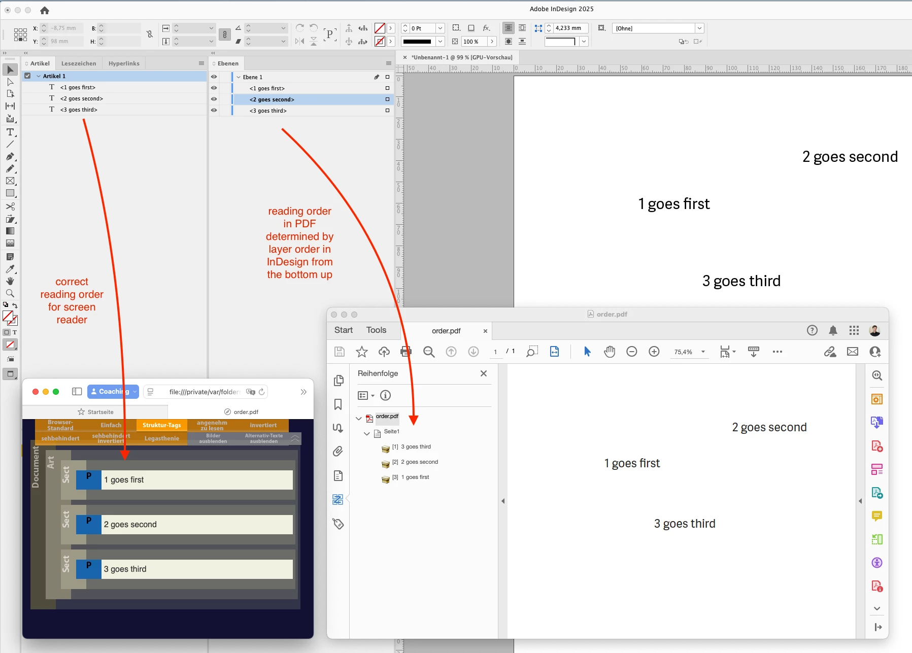

To further illustrate this look at my screenshot. I have three separate text frames randomly placed on the page. In the Article Panel I define the tag reading order for the screen reader which you can check in the exported PDF with PDFgoHTML (on the left).
The reading order in the PDF is completely different and depends on the layer order of the objects in InDesign – from the bottom up – I know this sounds weird. As you can also see in the Reading Order in Acrobat.
That the reading order in Acrobat has influence on real screen readers is not correct. The tag reading order is the important thing and that is defined in the Articles Panel – as long as you have the option “Use for tagging order in tagged PDF” turned ON.
