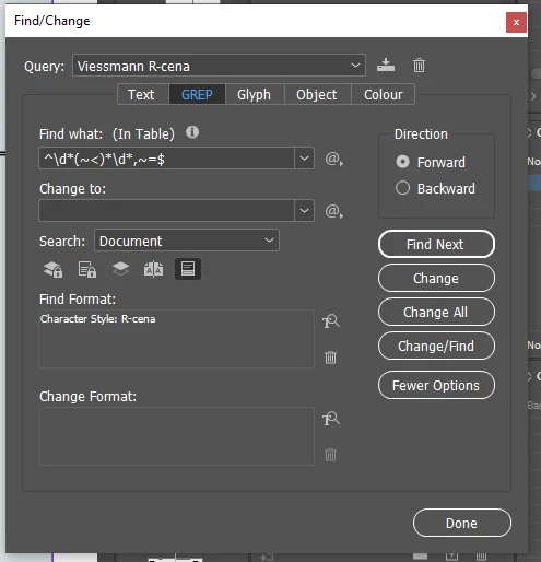

This is the query:
and in UI it will find this - which is what I'm looking for:

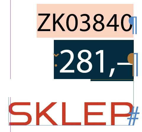

but through scripting - it will also include the graphics below, from the next paragraph - that is also styled with "R-cena"...
What am I doing wrong ?
I've added ^...$ in the hope, that it will find only single line texts - but it still includes EVERYTHING after the "281,-"??

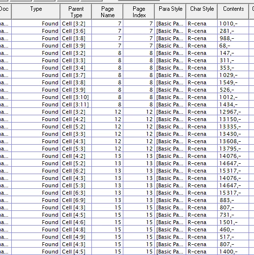

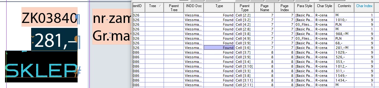

Looks like something is wrong with:
Call myInDi.LoadFindChangeQuery(myLQueryName, idSearchModes.idGrepSearch)
Because, if I enter the GREP query as a parameter for the GREP Search:
it works as expected:
but if run like this:
will return wrong results...
Yes - this query is slightly different than before - (...) instead of  ^...$ - but it works when I execute search from script with this query - but returns wrong results when I try to load it as a saved query...
