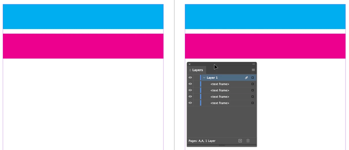

I'm a visual learner, so I almost always answer with a picture or a short video clip. My take on this initial confusion to your question was the reference to layers versus frames on a layer. In my pic below, there is one layer with four rectangle frames on that one layer.

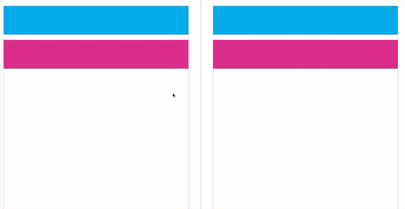

It's very common to have multiple parent pages (previously called master pages) in a single InDesign file. And an efficient way of working is to base a new parent page on a previous parent page. When you do that, everything from the first parent page is visible on the new one. You can Ctrl+Sh+click (Mac: Cmd+Sh+click) on any frame to select and delete it. Here's my clip to provide the visual: the A Parent has the four frames—two blue and two pink—and both are visible on the B Parent, which is linked to the A Parent. I am Cmd+Sh+clicking the pink frames and pressing Delete, and then assigning B Parent to body pages 2–3.
