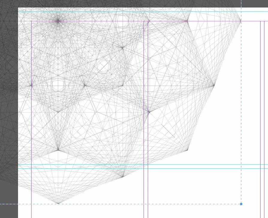

I have a problem with the lineweight can you help me with that ?
On in Indesing it shows me diffrent lineweigt and then when I am exporting my file it shows me complitly diffrent line-weight.
I wanna keep exactly as I have on my Indesign file
Thank you

Indesign preview is not really great. Definitely the pdf is more accurate.
You should alter the original image
February 3, 2020
It is a vector file and light-weight is on 0.001 but on pdf it shows me like 0.25
Dave Creamer of IDEAS
February 4, 2020
Are we talking about points to points? A 0.001 pt rule would probably not print--I'm not sure it would display properly unless zoomed in. Acrobat may be enhancing the preview.
Did you check the width with the Object Inspecter?
Are you sure the Fix Hairlines was not run as part of a preflight?
