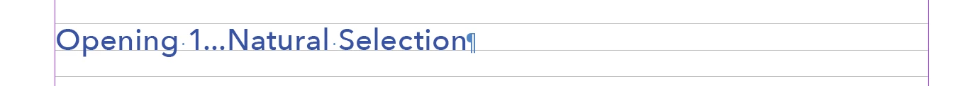

I have 2 InDesign files (separate chapters of a book) with the same subheading paragraph style in which the font color is set to "Blue."
The intensity of the blue is very different between the 2 files - see attached.
Once I noticed the difference, I slightly renamed the style that showed as brighter blue and imported it into the the other file. It too showed as the dull shade of blue.
I cannot figure out why this is happening.
Thanks in advance for any assistance.

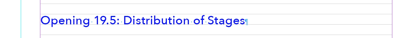

Mar 5, 2025 12:51 AM UTC
AAAhhh!!! You got it !!! Thank you !!! (sorry iIcould not respond sooner...I had to be out most of the day.)
Overprint preview was not turned on in the "dull" blue file. As soon as I turned it on I got the vivid blue.
Please see the attached 2 images - when Overprint Preview is turned on I loose the paragrapgh sumbols. Is there w ay of having both vivid blue and paragraph symbols ?
Robert at ID-Tasker
Mar 5, 2025 1:01 AM UTC
@Michael J B
Last option in the Type menu - Show Hidden Characters.
But you'll have to be in Preview / Normal mode.
